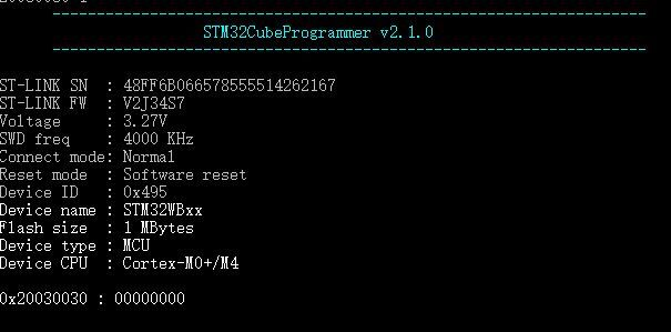

Htzuh
I found that the ICs (stm32wb55RGV6) which i bought had no FUS.
As shown below
Is it normal situation? Should i need to download and install
DFU at first?
Thanks.

No FUS on your chip is not a normal situation. So load FUS V1.0.1 in your case before going any further in the update of the BLE stack.

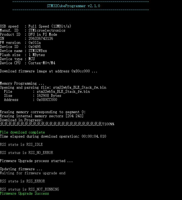

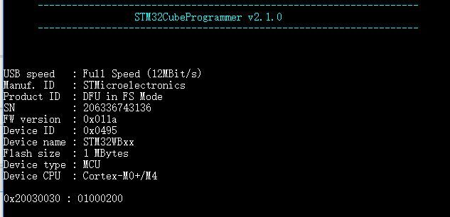

Hi ,
This is the FUS version i installed.
0690X0000098FX3QAM.jpgThen, I installed the stm32wb5x_BLE_Stack_fw.bin.
0690X0000098FXXQA2.jpgBut , the prgram still can't enter into APP_BLE_Init( ); .
The only working is M4 core.
Thank you .
The RF stack update looks OK.
