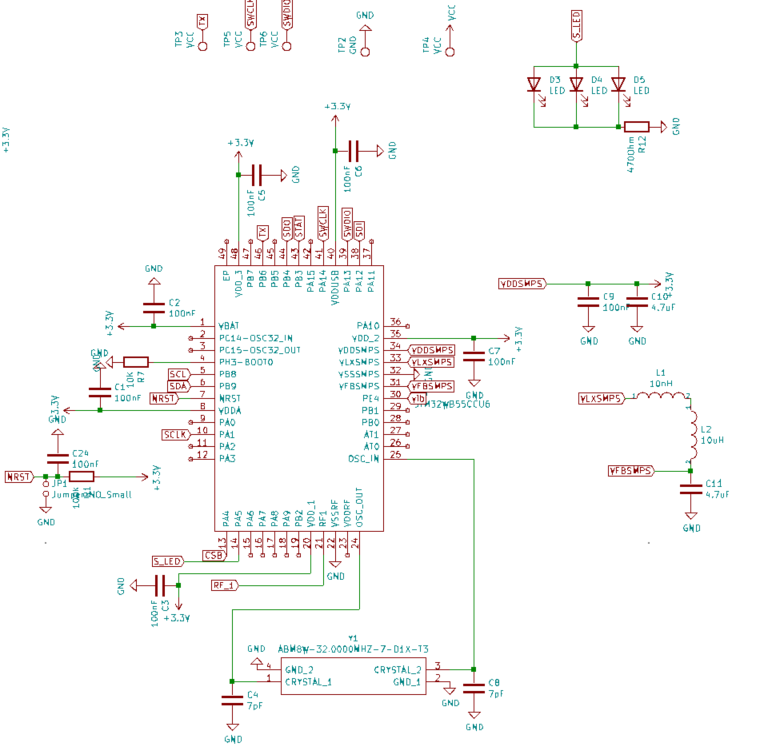

Hello! I'm working on a custom STM32WB board (schematic attached -- I jumped VDDRF to 3.3V)0693W00000D0NVOQA3.png
I'm trying to create a basic project and pull PA5 (My LED pin) high to verify programs run.
I'm using CUBE IDE and set pin PA5 to GPIO_Output with output level as high. Here is my GPIO_Init:

I have a ST Link V2 and I've stepped through the program using the debugger. Checked to see if the PC is being incremented (it is), and can't think of anything else to test at this point... Is there a way to check and see if the core is actually running the program other than stepping through it? I figured setting a GPIO high would be a basic step..

I can't see anything wrong with the code or schematic. I didn't check the SMPS stuff.
Can you debug and step through the code to verify it's actually getting to the main loop?
Can you verify the LEDs are soldered with the correct polarity. Should be able to use diode drop mode on a multimeter to confirm.

Yes, I stepped through the code to get to the main loop and it made it. I also checked to make sure LEDs are soldered correctly and used my oscilloscope to verify the pin wasn't outputting anything.
Also verified they were soldered in correct position by using a 3.3V voltage reference and manually pressed it against the side of the LEDs going to PA5. The board is correct. I even reflowed the chip to make sure the pad was touching PA5. Also.. tried driving another pin I can access high and that didnt work either.

If the GPIO registers say it should be output high, but it's not, and you've verified connectivity, I'm out of ideas, aside from a hardware failure.
I don't know of anything special about PA5 but maybe there's a WB-specific thing I don't know about.
How do I check the GPIO register? In debugger mode going through in CubeIDE I can see it changing the values, but I'm not sure if it's actually set. Is there a tool where I can verify the register is set?
You can view peripheral registers in the SFRs view.
Windows -> Show View -> SFRs
What register would I be looking for? And what do I do if the register isn't being set? I wont be able to test this for a few hours. I want to have a solid game plan when I get to it later.
The GPIO register details are in the reference manual. Ensure the mode and odr values are correct.
If register settings aren’t correct, you look for a software bug and fix it.
If register settings are correct but the output is not as it should be, you look for a hardware bug and fix it.
