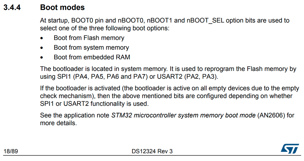

Hello, I have a wearable design which consists of 2x STM32 MCUs (One STM32WB and a STM32L010K8). They are connected via I2C and I need to be able to reprogram the STM32L010K8 using the STM32WB via the I2C port. However, there's mixed information related to the capability of the ROM bootloader to communicate via I2C. The first page of the STM32L010K8 datasheet says that the pre-programmed bootloader supports SPI and UART. Then on page 18 (Boot modes) it states that I2C on pins PB6 and PB7 can be used to reprogram the flash memory.
Which one is correct? Can anyone here confirm if the STM32L010K8 can be reprogrammed via I2C using the ROM bootloader?

So, I confirm that AN2606 is the correct one (aligned with front page content of the datasheet where I2C bootloader isn't listed).
The content of section 3.4.4 will be updated to remove I2C in coming versions of STM32L010K8 datasheet.
Are you sure you're looking at the right/recent datasheet?
https://www.st.com/resource/en/datasheet/stm32l010c6.pdf
Nothing there about I2C support.
AN2606 doesn't say it has I2C support either.
If you've got the hardware in front of you how hard could it be to test it yourself?
AN2606 suggests it's only SPI and UART for L01x
https://www.st.com/resource/en/application_note/cd00167594-stm32-microcontroller-system-memory-boot-mode-stmicroelectronics.pdf

I should have been more specific with the device I'm trying to design with. It is this one: https://www.st.com/en/microcontrollers-microprocessors/stm32l010k8.html
Yes, I checked AN2606, but the datasheet says I2C should work, therefore I'm still hoping that I2C is available for the ROM bootloader. I don't have the device in front of me as I working on the PCB design at the moment and so far I haven't seen any EVAL or DISCOVERY kit with it that I could order to try it out.
