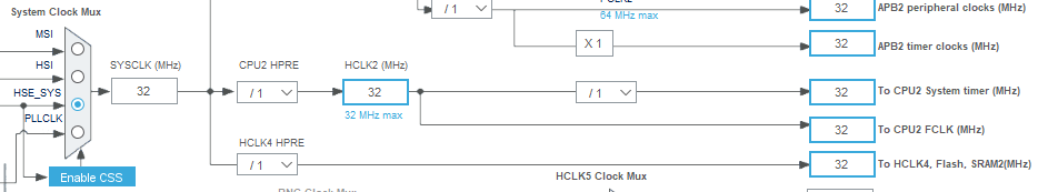

Maybe it's possible to turn off the clock for CPU2 (HCLK2) in RCC configuration?

Since my question I got the answer for my question directly from ST, it is NOT possible to reset it once CPU2 has boot.
The thing is I had several other problems in my firmware, and now they are solved, putting CPU2 in STOP MODE 2 make it consume nearly 0, which is good enough for me.
