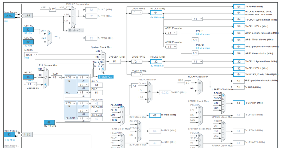

I'm trying to generate a 64 kHz PWM with 50% dutycycle.
I've configured the SYSCLK to use the HSE in combination with the PLL resulting in 64 MHz. Since I'm using TIM1, which is on APB2, I've configured the APB2 timer clock also to 64 MHz.
However, if I configure TIM1 (no prescalers) to a period of 1000 and a PWM pulse of 500 the generated frequency is not 64 kHz but 32 kHz.
Did I misunderstand something? Where is the additional division by 2 happening?
Thanks
Regards
secures
Clock configuration:
Cube generated code:

Nikita91
Lead II
To get no prescaler, the prescaler value must be 0 according to the ref man:
"The counter clock frequency (CK_CNT) is equal to F_PSC / (PSC[15:0] + 1)."
3 REPLIES 3
Nikita91
Lead II
secures
Well that was the missing part. Thanks
Note also that if you want 1000 ticks per period, you need to set the period to 999.
