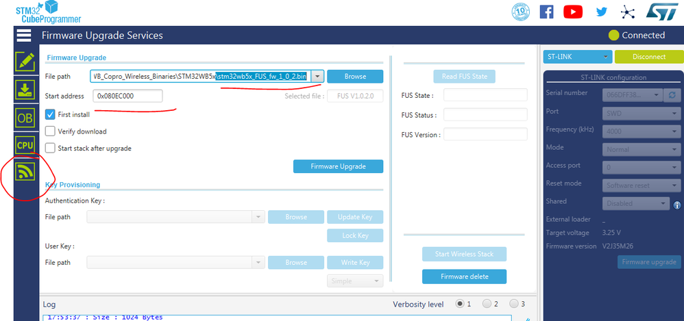

  • "Firmware Delete"
  • Then, I first "Firmware Upgrade" with "stm32wb5x_FUS_fw_1_0_2.bin" at the address 0x080EC000, so not directly the v1.1.0 version (I checked the "First Install box")

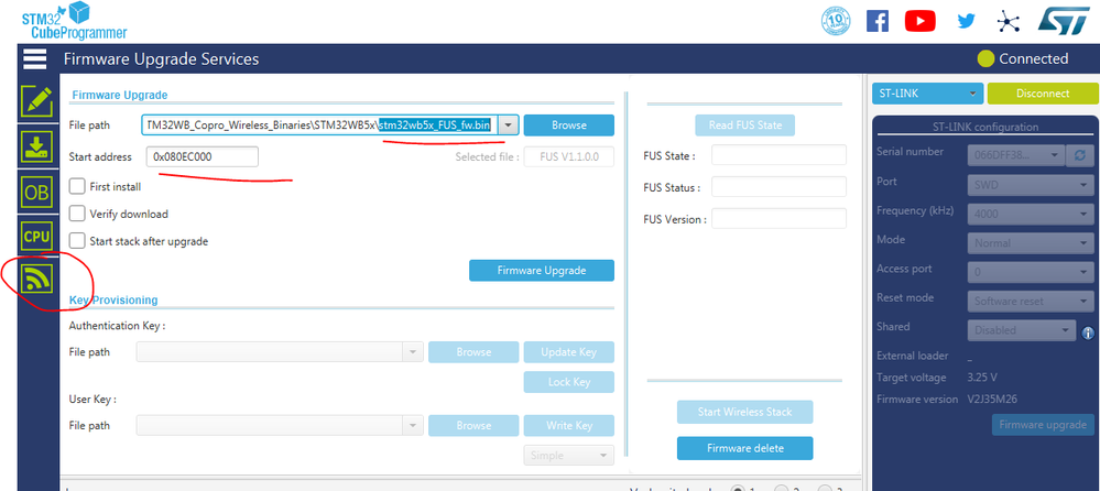

  • Then, I upgraded with the "stm32wb5x_FUS_fw.bin" at the address 0x080EC000, unchecking all the boxes.

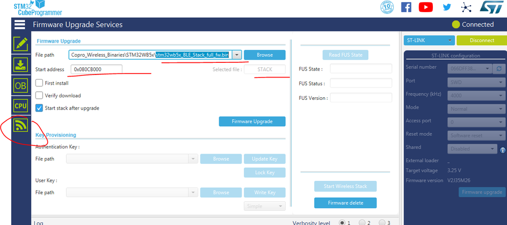

  • Then you will be able to Upgrade Firmware with the Coprocessor application you need, for I used the "stm32wb5x_BLE_Stack_full_fw.bin" on the address corresponding to your WB55. On the Nucleo board it is the STM32WB5xG, so at the address 0x080CB000 for this firmware (there is a Release_Notes in the CubeMX package with a table that give these information).

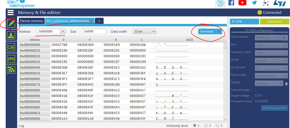

  • Finally, maybe after a reset, you should be able to download an Application to the 0x08000000 address, for example the P2P_server example. You will see that the RF stack is working correctly.
