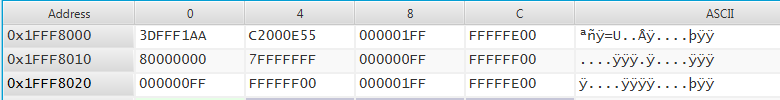

​Are you able to connect to the board via the Cubeprogrammer tool? If yes what are the option bytes?

​Before going any further, can you show me the option bytes on your board?

"He's dead Jim": As I mentioned before, none of the debug/programming tools is able to establish a connection to the target, hence I can't show you the option bytes of the dead specimens. What I can provide to you is the option bytes of the remaining specimen.
