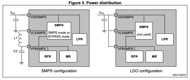

  • I compared the voltage on the dongle with my custom board, and the difference I find is on pin VLXSMPS, and VFBSMPS. It is 3.3V on dongle, but 0V on mine. What could be the reason ?
    • It is not shorted to GND.
    • I tried to short it to VDD, but it didnt help

If you are suspicious of the SMPS you could try modding the circuit to the LDO configuration just as a test:

I will try the LDO
TEsli.1
That's the same in LDO, but good point. Thank you
