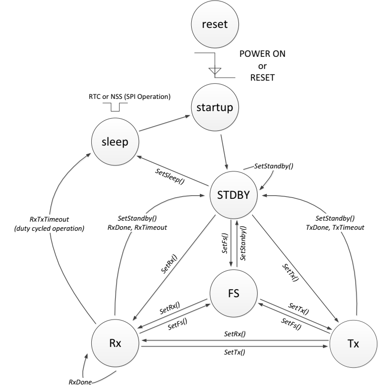

I am trying to switch between modes (standby, rx, tx, sleep) in the sx1262 module. While switching, I pay attention to the figure below in the datasheet of the lora module. For example, to switch from SX126X_STANDBY_CFG_RC mode to RX mode, I use the command sx126x_set_rx(&myLoRa, 0). Then I use the command sx126x_get_status(&myLoRa, &radio_status) to check if the module has switched to rx mode but the cmd_status value is read as "SX126X_CMD_STATUS_CMD_EXEC_FAILURE" and the chip_mode value is read as "standby".

The read and write functions are as follows. Does anyone have any information about the problem?
sx126x_hal_status_t sx126x_hal_write(LoRa *context, const uint8_t *command, const uint16_t command_length, const uint8_t *data, const uint16_t data_length)
sx126x_hal_status_t status = SX126X_HAL_STATUS_OK;
HAL_GPIO_WritePin(context->NSS_port, context->NSS_pin, GPIO_PIN_RESET);
if (HAL_SPI_Transmit(context->hSPIx, command, command_length, HAL_MAX_DELAY)!= HAL_OK) {
status = SX126X_HAL_STATUS_ERROR;
while (HAL_SPI_GetState(context->hSPIx) != HAL_SPI_STATE_READY);
if(data != NULL && data_length > 0)
if (HAL_SPI_Transmit(context->hSPIx, data, data_length, HAL_MAX_DELAY)!= HAL_OK) {
HAL_GPIO_WritePin(context->NSS_port, context->NSS_pin, GPIO_PIN_SET);
return status;
sx126x_hal_status_t sx126x_hal_read( LoRa *context, const uint8_t* command, const uint16_t command_length, uint8_t* data, const uint16_t data_length)
if (HAL_SPI_Transmit(context->hSPIx, command, command_length, HAL_MAX_DELAY) != HAL_OK) {
if (data != NULL && data_length > 0) {
if (HAL_SPI_Receive(context->hSPIx, data, data_length, HAL_MAX_DELAY) != HAL_OK) {
status = SX126X_HAL_STATUS_ERROR;}
return status;
Ruandj
Good day,
I have the exact same problem, any update on a solution?
