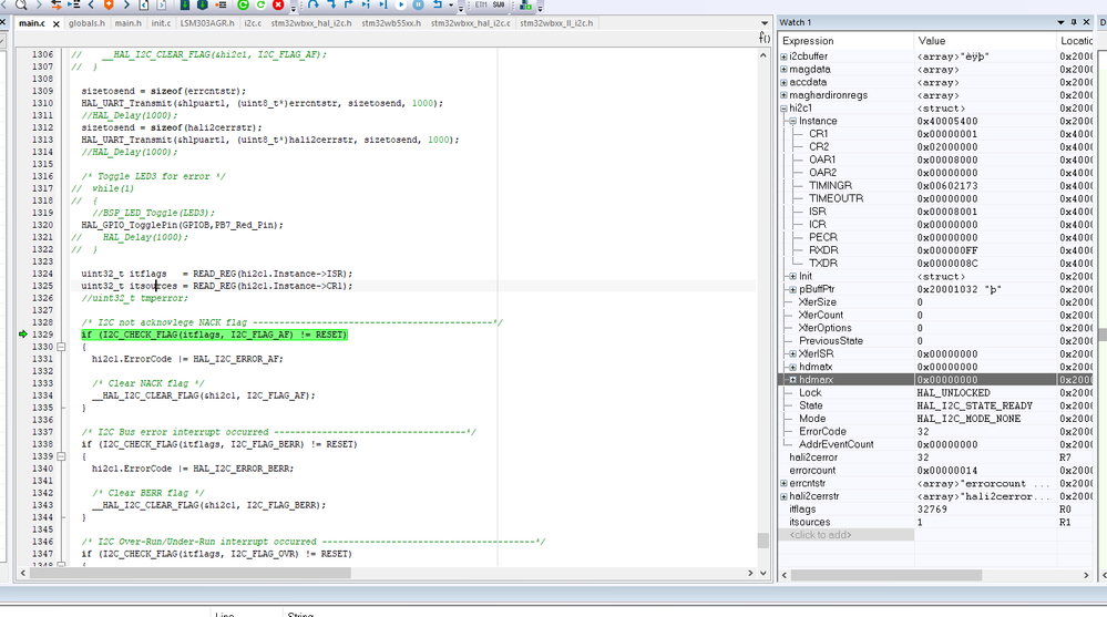

0693W000001sxN6QAI.pngI am using the STM32WB in master mode, polling a single LSM303AGR accelerometer. Using the HAL transmit routine as follows:

The last two variables in the debug window are obtained as follows at the start of the Error_Handler() routine:
uint32_t itflags  = READ_REG(hi2c1.Instance->ISR);
 uint32_t itsources = READ_REG(hi2c1.Instance->CR1);
Not interrupt, just polling. Every so often, it jumps to the Error_Handler() routine which just toggles an LED in a while(1) loop indefinitely. I am trying to determine the cause of this error.
Attached is a picture of the debugger screen showing the i2c instance and all relevant variables. From this picture, can anyone help me determine the cause of the error? It's taking 2 days of runtime to catch this so any help would be appreciated.
Thanks
1 REPLY 1
Your hi2c1.ErrorCode value is 32 which matches up with a timeout error.
#define HAL_I2C_ERROR_TIMEOUT (0x00000020U) /*!< Timeout error */
So that is the reason. It's probably getting set in I2C_WaitOnFlagUntilTimeout which is called in two different places in HAL_I2C_Master_Transmit.
Potential cause is that the I2C bus is busy due to a misbehaving device. Use a logic analyzer to find out more info.
