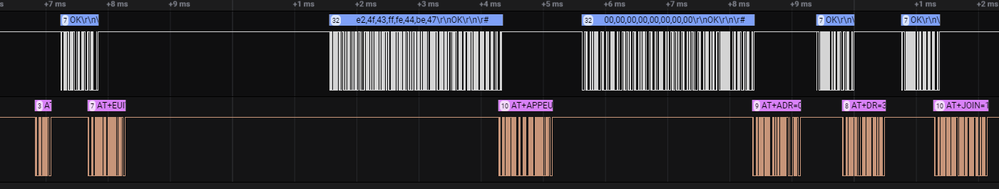

I just bought a LRWAN2 pack, I was able to connect the gateway to the TTN network and application server. But the APPEUI i the join request was wrong (only zeroes). So I plugged an oscilloscope on the RX and TX pins an it shows that:
_legacyfs_online_stmicro_images_0693W00000dDdTxQAK.pngDoes this mean the LRWAN1 board is dead?

I'm having the same problem. Reading the memory 0x08080000 on the NUCLEO gives the correct DevEUI, but reading memory 0x08080008 gives me zeros only. Furthermore, I included the code-snippet
uint8_t AppEUI[8] = {0xAB, 0xAB, 0xAB, 0xAB; 0xAB, 0xAB, 0xAB, 0xAB};
uint8_t *ptr = &AppEUI;
LoRa_SetAppID(ptr);
in the AT_Master project, but still the memory  0x08080008 is all zeros :(
