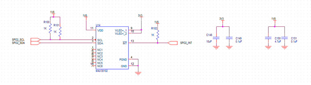

Hi Team, i used to design STM32WB5MMG IC for my application. i have temperarture sensor MAX30102. i need to communicate with mcu with i2c .its working on 1v8.shall i connect directly to mcu i2c? or 3V3 to 1V8 level translator is required inbetween?

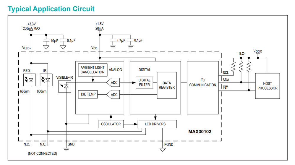

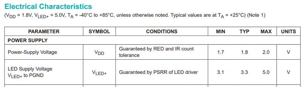

The MAX30102 operates on a single 1.8V power supply and a separate 3.3V power supply for the internal LEDs. (DATASHEET)
0693W00000Y8twCQAR.png So, try to provide 1V8 as a power supply for the sensor MAX30102.
Foued
AJAY S
this is my shematic design sir here i2c i use 1v8 is that okey to communicate STM32WBMMG chip. in between 3v3 to 1v8 level shifter is required? or not thats my doubt0693W00000Y8u5EQAR.png
Foued_KH
I think you are alright as recommended in the Datasheet of the sensor MAX30102 :
0693W00000Y8uG7QAJ.pngFoued
MY host is 3V3 sir,but my sensor is 1v8 thats why i had confussion.

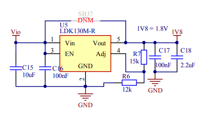

Try to use a regulator to provide 1V8 like the LDK130M-R.
0693W00000Y8uIhQAJ.pngI advice you take a look : Schematic diagram Motion MEMS and environmental sensor expansion board for STM32 Nucleo -

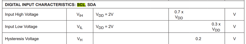

MM..1
Chief III
You can use it , because is in max ratings but need have this levels in range primary low under ...0693W00000Y8uwwQAB.pngas you see High dont have defined up limit ... abs max ratings is 6V
thank you for your support
