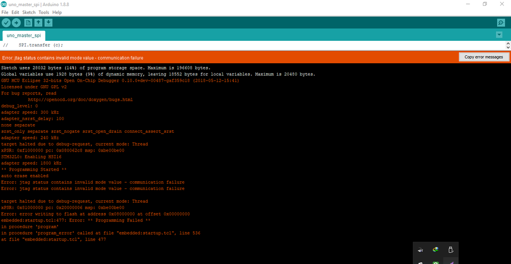

I have two B-L072Z-LRWAN1 discovery board.
Installed board support package from https://github.com/GrumpyOldPizza/ArduinoCore-stm32l0
I can able to program 1board using arduino ide but when i try to upload on 2nd Board its gave following error
This same board is working on Keil IDE mean i can able upload program using keil IDE.
So no board issue.
I want to upload program Using Arduino IDE only.
can any one help me in this?
Thanks.

Perhaps the second board has write protection. Did you check?

Erase the firmware currently loaded on the board. Use ST-LINK utilities, and connect-under-reset settings, or with BOOT0 pull high if necessary.
Update the firmware on the ST-LINK to the most current.
>>But i able to do programming in Keil IDE.. so ?
The performance of OpenOCD frequently ***** when compared to commercial tools. Play with the connection settings if you think that will help. Use the most current version of the software.
