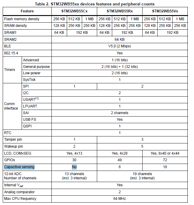

I'm start to develope a board with touch sensing capability using STM32WB55CEU 48 pin but is System Tab on CubeMX i can't find TSC peripheral.. cube is at 5.6.0 and FW package for STM32WB is 1.5.0

Hi, 55Cxx do not have Capacitive sensing.
Look at datasheet DS11929 : Table 2. STM32WB55xx devices features and peripheral counts

Indeed the 48-pin package does not support the TSC feature.
