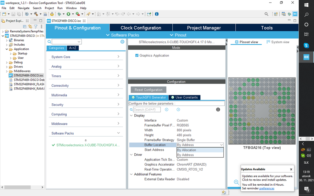

When you need reply how with internao RAM, then simply select framebuffer by Allocation and generated code is prepared...

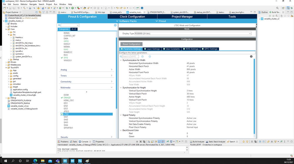

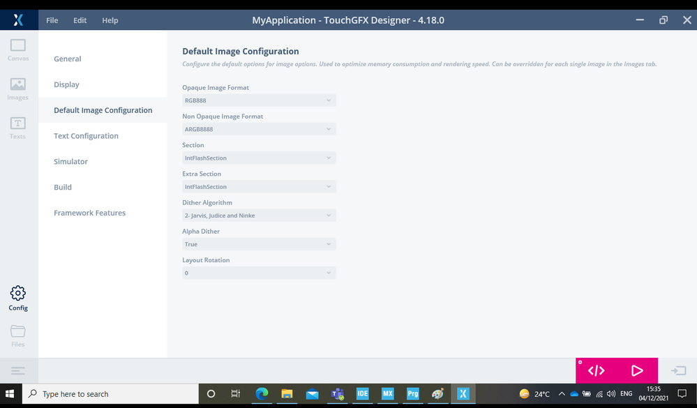

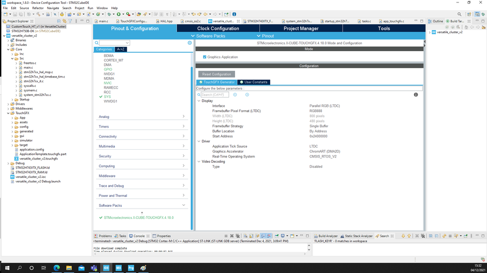

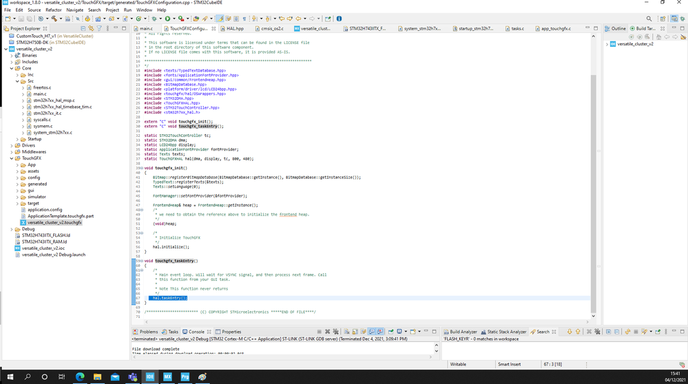

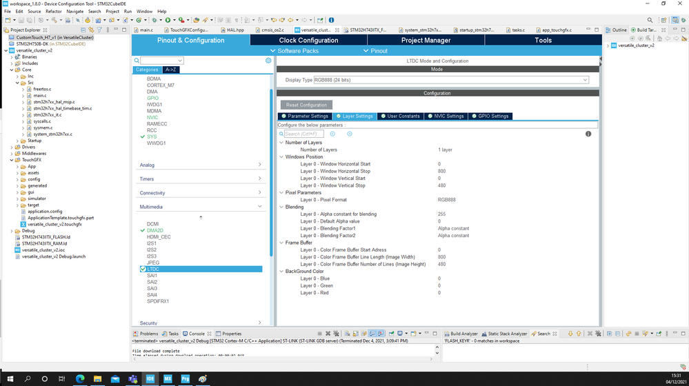

Hello Dear,
my project stuck on hard fault when code reaching at " hal.taskEntry()" is use in task function
i am attaching screen shots of configuration

What isnt clean on simply select framebuffer by Allocation?
You choice By Address *** select 240000 is here space for buffer? 800x480X3 bytes? Isnt used by linker ?
