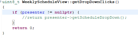

I've created a list and need to get value from model.hpp and using
WeeklyScheduleView objs;
drops = objs.getDropDownClicks();
to get value. But when it calls it crashes.

Check if presenter is a valid pointer, maybe it is uninitialized.
When this account seems to be inactive, try @tdecker2 - ST can't change mail addresses, so I had to create a new account.
Do you mean about this?
Set a breakpoint to the line return presenter->getScheduleDropDown() and see if presenter has a valid address or check at runtime with if (presenter != nullptr) { the line before

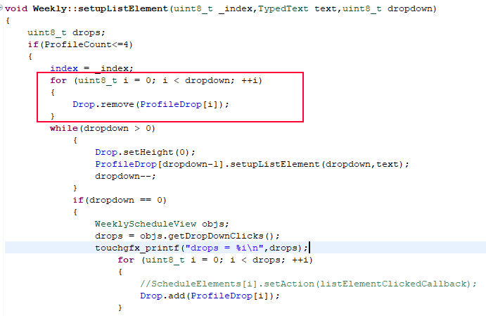

When I debug it crashes at this point but when I do not call another object it works fine.
_legacyfs_online_stmicro_images_0693W00000biEQOQA2.pngi've tried to comment this function and still crashes:
Osman SOYKURT
Hello heyo,

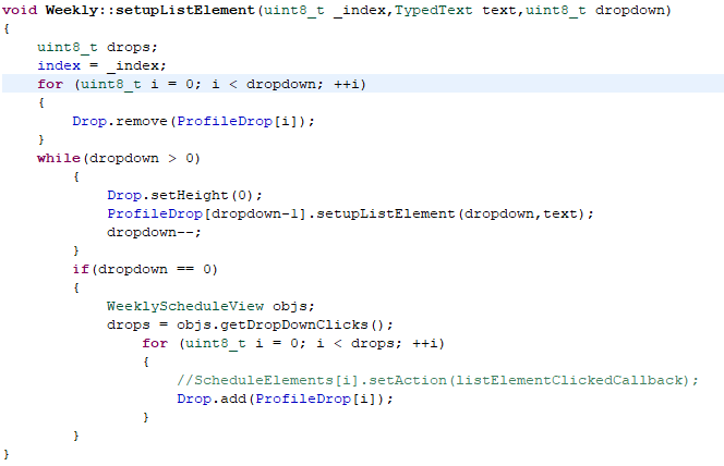

It crashes at Drop.remove(ProfileDrop[i]) or drops = objs.getDropDownClicks() ?
Also, what is your Drop object?
/Osman
Osman SOYKURT
At drops = objs.getDropDownClicks(). It always crashes when I try to call function in other class.
Do you mean Drop? Drop is a list. The only way calls other function in other class works when container is included in view window
