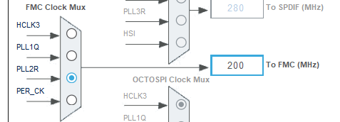

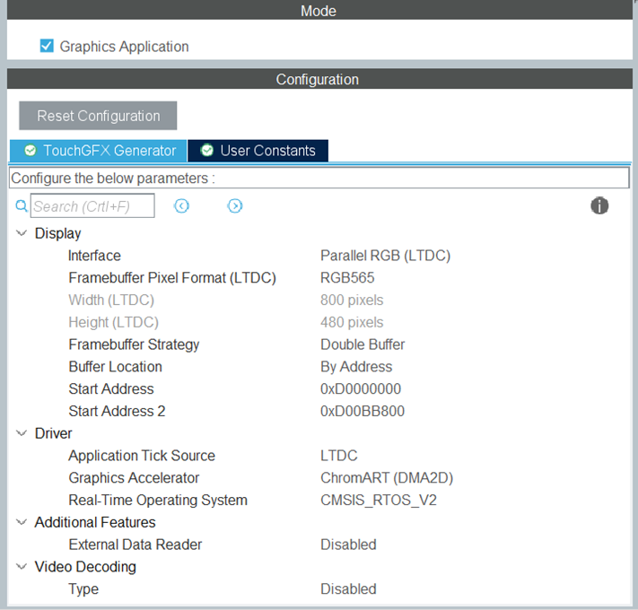

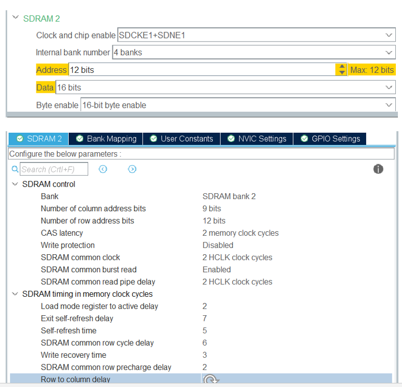

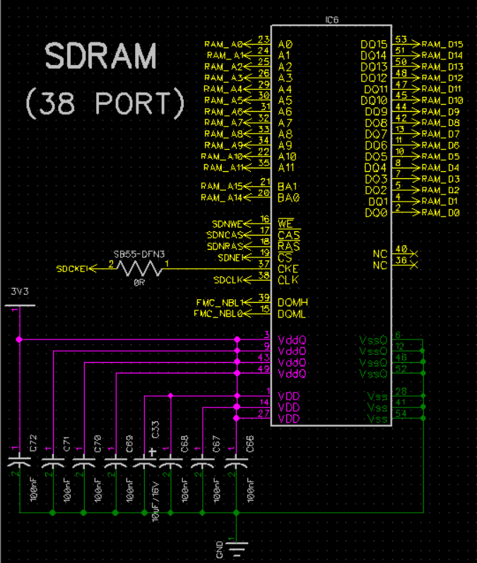

I am using below development tools
MCU: STM32H7B3IIT6
IDE: STM32CubeIDE Version: 1.8.0
GUI: TouchGFX Version: 4.18.1
SDRAM: IS45S16800F-7CTLA1-TR
When activeted SDRAM, touch part dont work and screen is frezee, FMC settings are as follows.
0693W00000KZs5AQAT.png0693W00000KZs5yQAD.png0693W00000KZs6SQAT.png0693W00000KZs8dQAD.png

  hsdram2.Init.SDBank = FMC_SDRAM_BANK2;
  hsdram2.Init.ColumnBitsNumber = FMC_SDRAM_COLUMN_BITS_NUM_9;
  hsdram2.Init.RowBitsNumber = FMC_SDRAM_ROW_BITS_NUM_12;
  hsdram2.Init.MemoryDataWidth = FMC_SDRAM_MEM_BUS_WIDTH_16;
  hsdram2.Init.InternalBankNumber = FMC_SDRAM_INTERN_BANKS_NUM_4;
  hsdram2.Init.CASLatency = FMC_SDRAM_CAS_LATENCY_2;
  hsdram2.Init.WriteProtection = FMC_SDRAM_WRITE_PROTECTION_DISABLE;
  hsdram2.Init.SDClockPeriod = FMC_SDRAM_CLOCK_PERIOD_2;
  hsdram2.Init.ReadBurst = FMC_SDRAM_RBURST_ENABLE;
  hsdram2.Init.ReadPipeDelay = FMC_SDRAM_RPIPE_DELAY_2;
  /* SdramTiming */
  SdramTiming.LoadToActiveDelay = 2;
  SdramTiming.ExitSelfRefreshDelay = 7;
  SdramTiming.SelfRefreshTime = 5;
  SdramTiming.RowCycleDelay = 6;
  SdramTiming.WriteRecoveryTime = 3;
  SdramTiming.RPDelay = 2;
  SdramTiming.RCDDelay = 2;
  if (HAL_SDRAM_Init(&hsdram2, &SdramTiming) != HAL_OK)
    Error_Handler( );

1 REPLY 1
Osman SOYKURT
Hello Freedom_Neo,
In your video, what the button is supposed to do ? From my point of view, I don't think it's only your touchscreen which doesn't work, I think your program has crashed (the clock stopped). Did you follow this documentation to setup your RAM ?
/Osman
