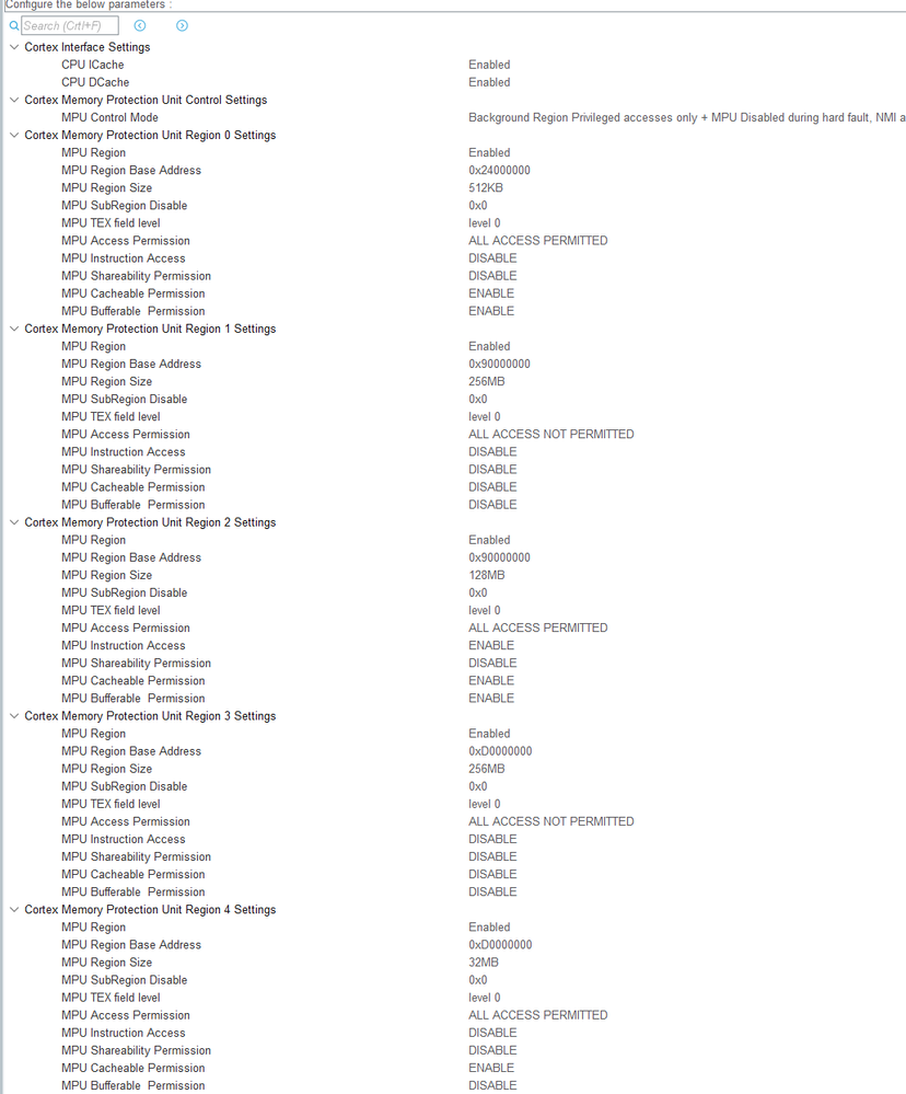

Recently, I started getting a wired glitch on the LCD periodically. I m using touchGFX 4.15 and CUbeIDE 1.5. After commenting some code relevant to the UI, Glitch doesn't comes. Any one have an idea what might cause this? Video is attached

Thanks for your reply. This is my MPU configuration.
This is my memory definition.

Can you help me out to figure this out. Because I dont have much knowledge in MPU.

Hi, I had this issue and I solved it by reducing the LCD-TFT clock rate. In my case (using an F769I-Disco) I changed it from 41.7MHz to 32MHz. If your UI slows down, make sure your optimizations are turned on. Good luck.
(As a matter of fact, the 41.7MHz came from the 3.0.0 F769 application template, and 32MHz came from the 3.0.2 template)
