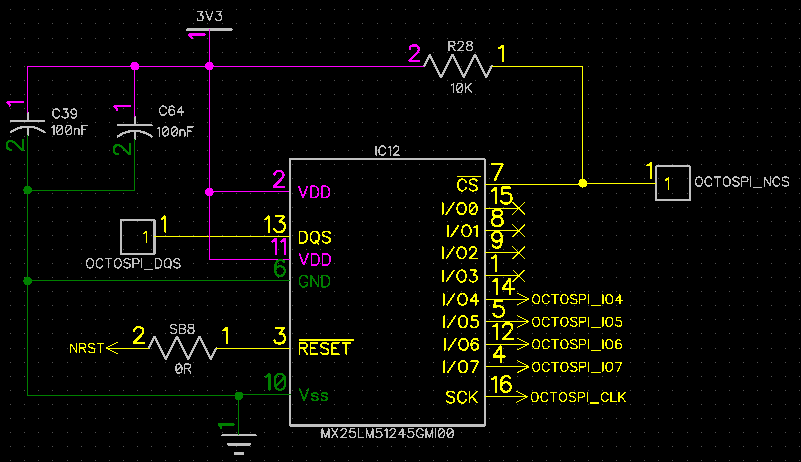

I use MX25LM51245GMI00 flash. But I dont have few pins so I use 4 pins for OCTO SPI. Does it work 4 pins OCTOSPI? What do I it for 4 pins OCTOSPI. What changes do I need to make
I dont see quad-spi mode. This FLASH for octo spi. MX25LM51245GMI00 dont support quad-spi. :(

That chip needs all 8 data lines connected per the datasheet. It has a 1-bit mode and an 8-bit mode.

What it takes to adapt for QSPI. Can I use the following driver code for QSPI? How can I run it as QSPI.
Open up the datasheet for MX25LM51245GMI00. Do you see a quad-spi mode available?
https://www.macronix.com/Lists/Datasheet/Attachments/7841/MX25LM51245G,%203V,%20512Mb,%20v1.1.pdf
