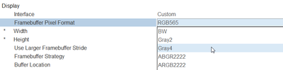

However, you can create a project in TouchGFX Designer, select the Simulator (not a board) and before creating you can choose the bpp :
Here 4 bit is monochrome.

I don't know what you mean by gray 32. You can select gray 4 in STM32CubeMX :
This way, your framebuffer will be in gray 4 format, you just  have to make sure your display is set to gray 4.
If you have assets without color in your GUI, you can build your project and TouchGFX Image Generator will convert your image.
Otherwise you can create your own assets in the correct format.
