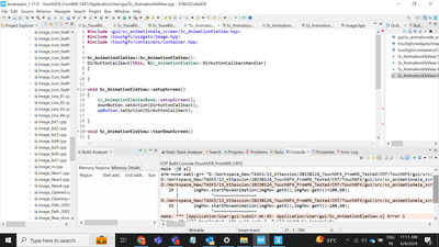

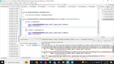

"Please confirm for me. Have you taken two images: one is a horizontal box with a down arrow (building image) and the other is a green box (floor)?"
From Two image you have used startMoveAnimation API for Green Box(Floor) ?
I have tried to use mentioned API but getting some error for linking file.
Please let me know if we needed to add some header file

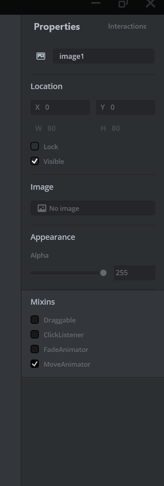

You need to check the checkmark for moveAnimator in TouchGFX designer like I mentioned before.
unsigned_char_array_0-1717486384299.pngLet me know if this helps. If not please test if it works in TouchGFX Simulator first and show the entire error message.
