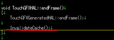

I had the similar situation.
I found the text flicker and below is countermeasure. It's just for your reference.
TouchGFXHAL.cpp

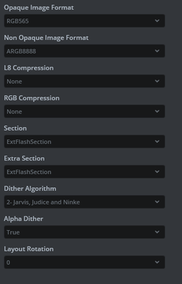

And what do you have in the default image configuration ? Try to put non opaque format to RGB565
Louis BOUDO
ST Software Engineer | TouchGFX
This is my TouchGFX default image configuration, and the RGB565 format option is not available in the Non-Opaque Image Format.
and, i'm sure this is cache issue.
because, for a moment, some parts of the tearing screen were flickering, displaying the correct colors.

MTana.1
TouchGFXHAL.cpp
