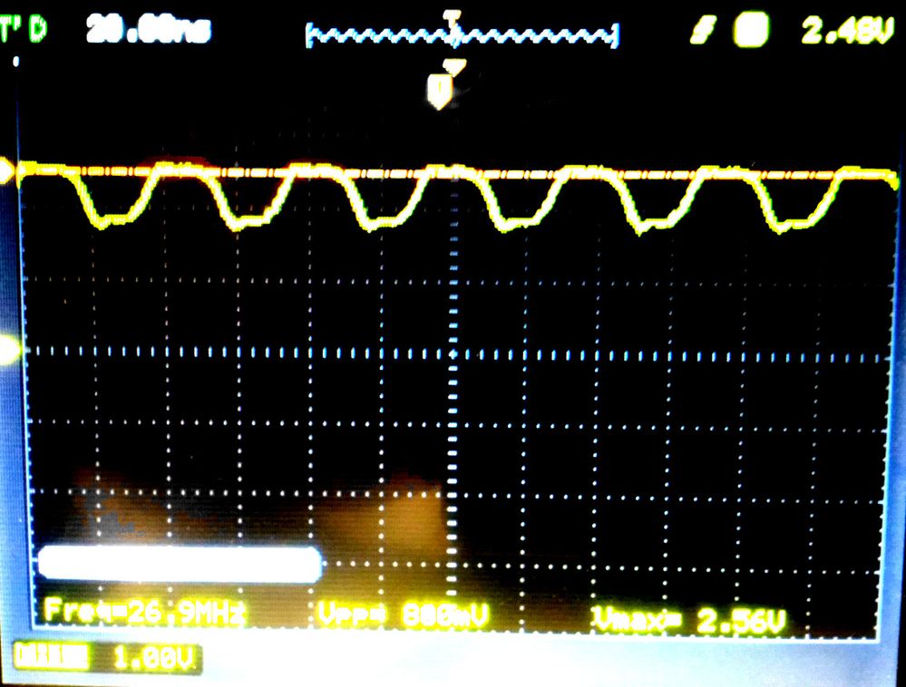

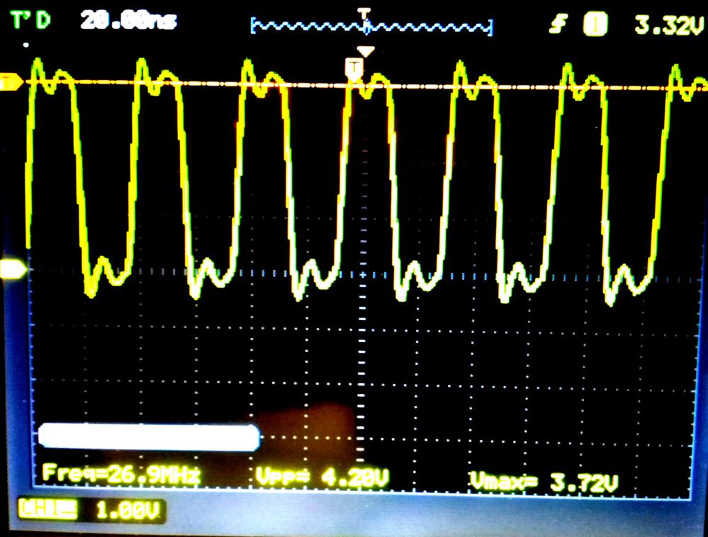

When I check the LTDC clock signal from MCU powered at 3.3V, I get the following output (the clock shape is distorted by my measuring system - I have relatively long cables connected to the NUCLEO board, and the oscilloscope proble is connected to these cables):

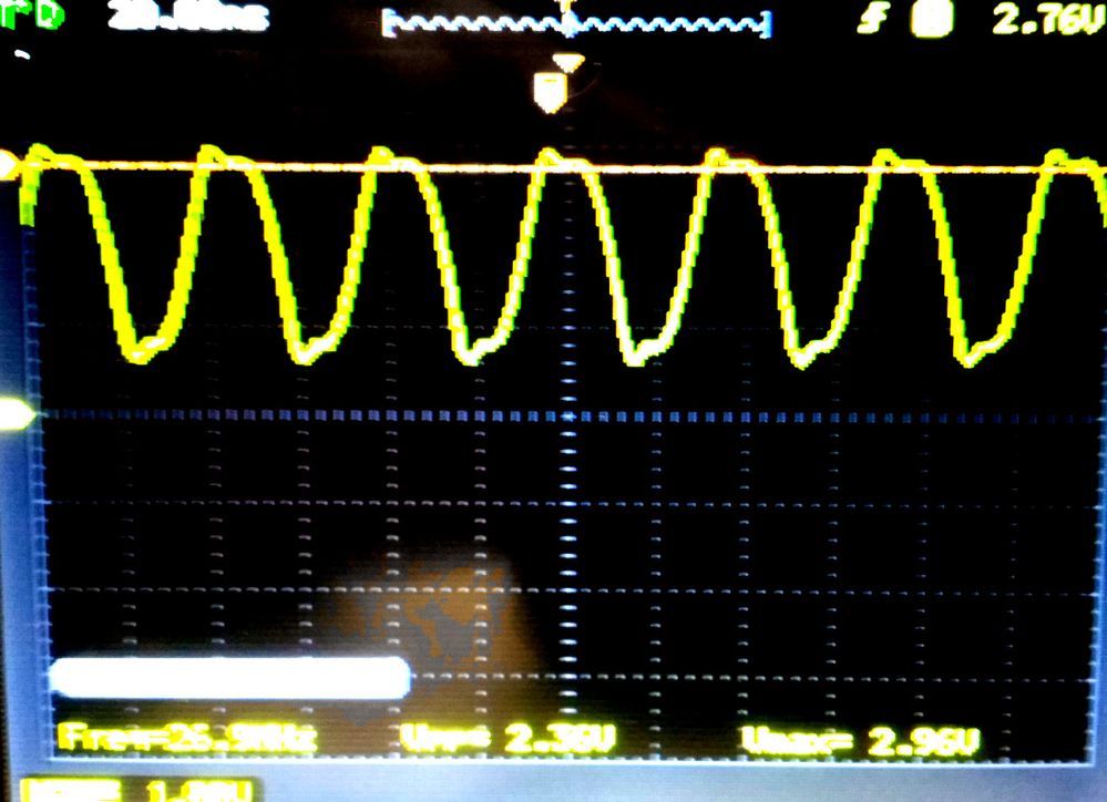

You can see that the signal has around 0.5V offset. As I decrease the input voltage, the offset increases. Here's how it looks for 2.8V (offset around 1.5V):

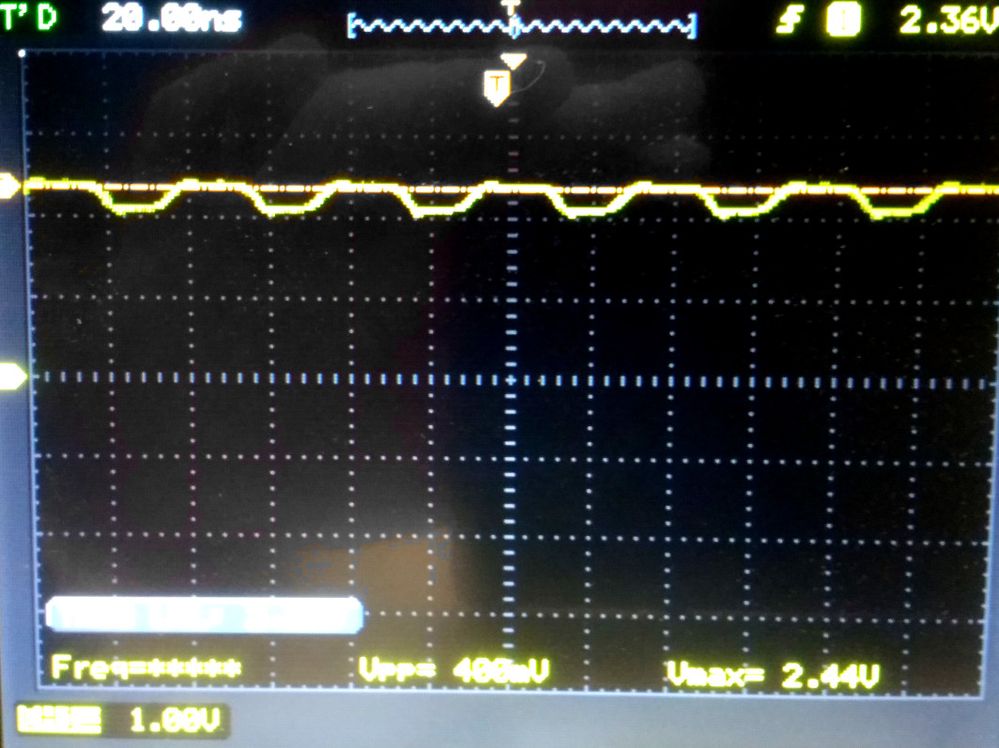

For 2.6V the offset makes the signal look like noise (and for lower voltages it's almost straight out flat):

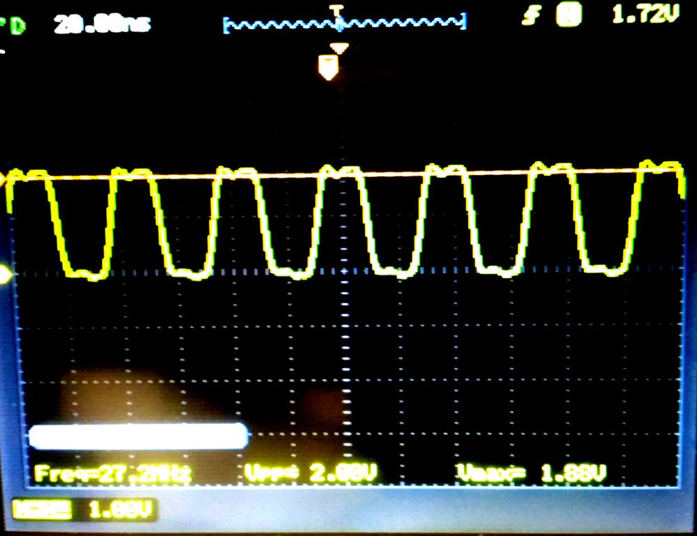

I have another clock configuration, which produces a significantly better signal. At 3.3V it looks like this:
whereas at 1.8V it looks like this:
which is exactly what I want. However, this configuration has an embarrasing side effect, namely that everything else except the clock (UART and all other LTDC signals) stops working.
