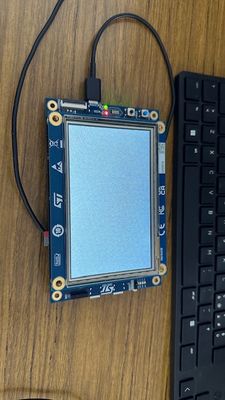

Fixed this I compile the code, load the firmware on my dk but the screen appears black (Backlight On but totally black).
Debugging and hitting the pause button the program is stuck in HAL_GPU2D_ErrorCallback as shown in the figure below.

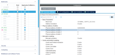

We have made a TBS (TouchGFX Board Setup) for the STM32H7S7-dk in 16bpp but also one in 24bpp :
Simple select the 24bpp and it should do what you want.
You can also create a project with both and look at the differences between them to see what we have changed to make it possible and compare that with the changes you have made yourself to see what was missing.

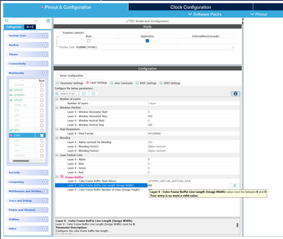

Meanwhile, opening the project on CubeMX I find the following error (error I find without having modified anything) see image "error" below.
Updated the code and simply doing the project build I find the error in image 2.
Once I fixed the error in image 2 via tutorial on known problems the screen appears to me as in image 3.

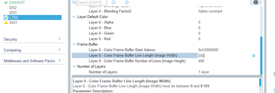

Hello @Leo_Berna99 ,
I suggest you to use the latest version of TouchGFX, STM32CubeIDE and STM32CubeMX.
The width cannot be between 0 and 0, I think the version of STM32CubeMX you are using is incompatible.

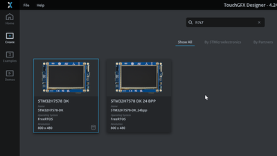

Have you tried to open TouchGFX Designer, create a new project, select the STM32H7S7-dk board in 24 bpp, flash and run from TouchGFX Designer?

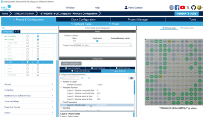

Your version of STM32CubeMX seems to not be the latest based on its looks.
Here is my STM32CubeMX (notice that the image width is between 0 and 8191) :
I've tried that but apart for the error in the width selection the pixel format is ARGB8888 and not RGB888.
What have you tried? Creating a 24 bpp project from TouchGFX Designer?
The format for the 24 bpp project is RGB888.:

I opened the project with the new version of TouchGFX (STM32H7S8-DK 24BPP).
I insert three colored circles and a generic background. I generate the code and open with CubeMX the .ioc file.
