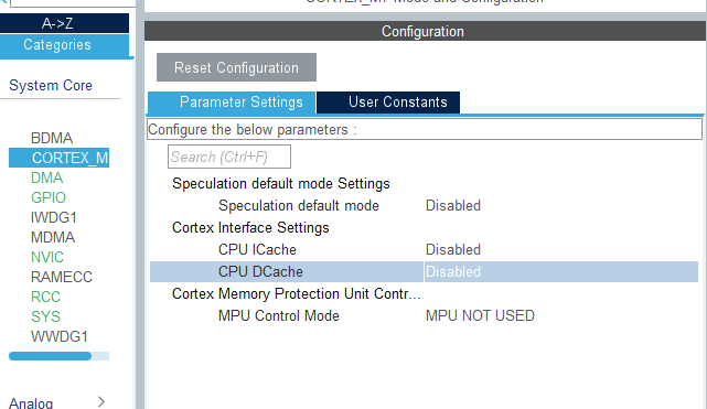

Maybe the problem is related to : memory layout and internal data cache (D-Cache) of the Cortex-M7 core. So, Try disable D-Cache and I advise you to follow this FAQ: DMA is not working on STM32H7 devices

MRoso.1
Hi, @Imen DAHMEN​
I made the necessary changes in the STM32H743ZITX_RAM.ld file and the DCcache option in STM32CubeIDE was already disabled.

I still have the same issue however of the buffer not being updated.
I am doing all this with STM32CubeIDE
