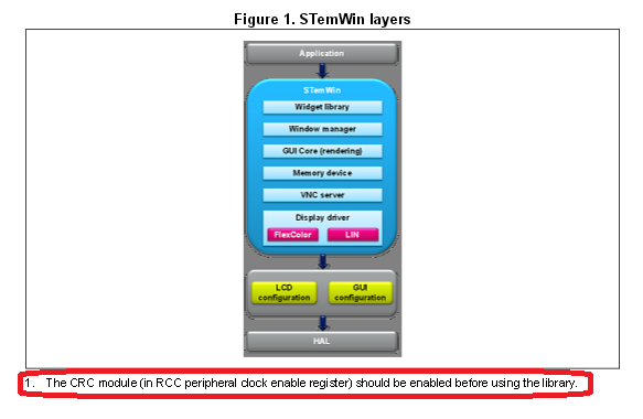

Posted on August 01, 2013 at 17:14
Hi Clive,
Thank you. This is correct and mentioned in our documentation to call that function prior to use GUI routines.  I thought that the default examples are used, which is active by default.
Cheers,
STOne-32.
mail2
Posted on August 01, 2013 at 17:31
Yes, that's it.
And yes, after searching for ''CRC'' in the documentation, i found a footnote(!) on page 6 of AN4323 about it.
Thank you again clive1.
Martin
Posted on August 01, 2013 at 17:42
I'm working blind with the register data you provided, the library is locked to STM32 hardware with this, presumably the F2 and F4, I didn't check the location on the F1
I think the documentation would have been a lot stronger if the main() example explicitly included this code. That note on the diagram is totally lost.
