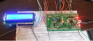

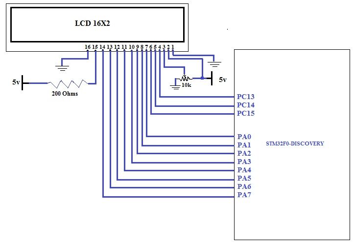

hi
i want show a text in LCD and i use LCDTS1620A-21 and stm32f0discovery 0690X00000605EwQAI.png 0690X00000602hlQAA.jpgand this is my code

but dont work :(((((((((( plz help me i am a beginerrrrrrrrr #stm32f0discovery #lcdts1620a-21

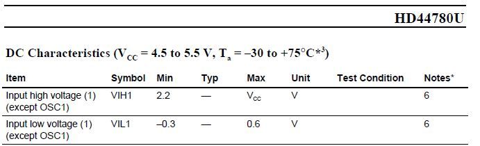

Didn't really looking at the code.
But driving a 5.0V peripheral (LCD) from a 3.3V MCU, this can't work.

The inference is that the VOL/VOH levels are incompatible. I've not looked at the data sheet for this specific display, so honestly couldn't say one way or the other. I'm using a similar one, but it's 3.3V rated.
http://www.newhavendisplay.com/specs/NHD-0216HZ-FSW-FBW-3V3C.pdf
Other peoples register level code really isn't something I'm going to spend my time on. Would suggest you look at other implementations using the Standard Peripheral Library.
Connectivity otherwise doesn't look bad, but you'd want to walk through the code, make sure the delays on the pins/signals are what you expect, and debug to understand if it's getting stuck somewhere, just not responding as expected.

''But driving a 5.0V peripheral (LCD) from a 3.3V MCU, this can't work.''
Except my friend - for those times - when it (surely) does!
Might (some) attention be paid to LCD's data manual?   I extract key portion, here:
Shown here - and our long (past 10+ year's use/success) of strictly 5V based character Lcds - w/3V3 MCUs (almost exclusively) proves this, VERY MUCH CAN WORK!
Retreat to the fine manual - or data sheet - always trumps ''guessing.''
Poster would do well to obtain HD44780 manual - read/absorb initialization code & timing - and try again.
