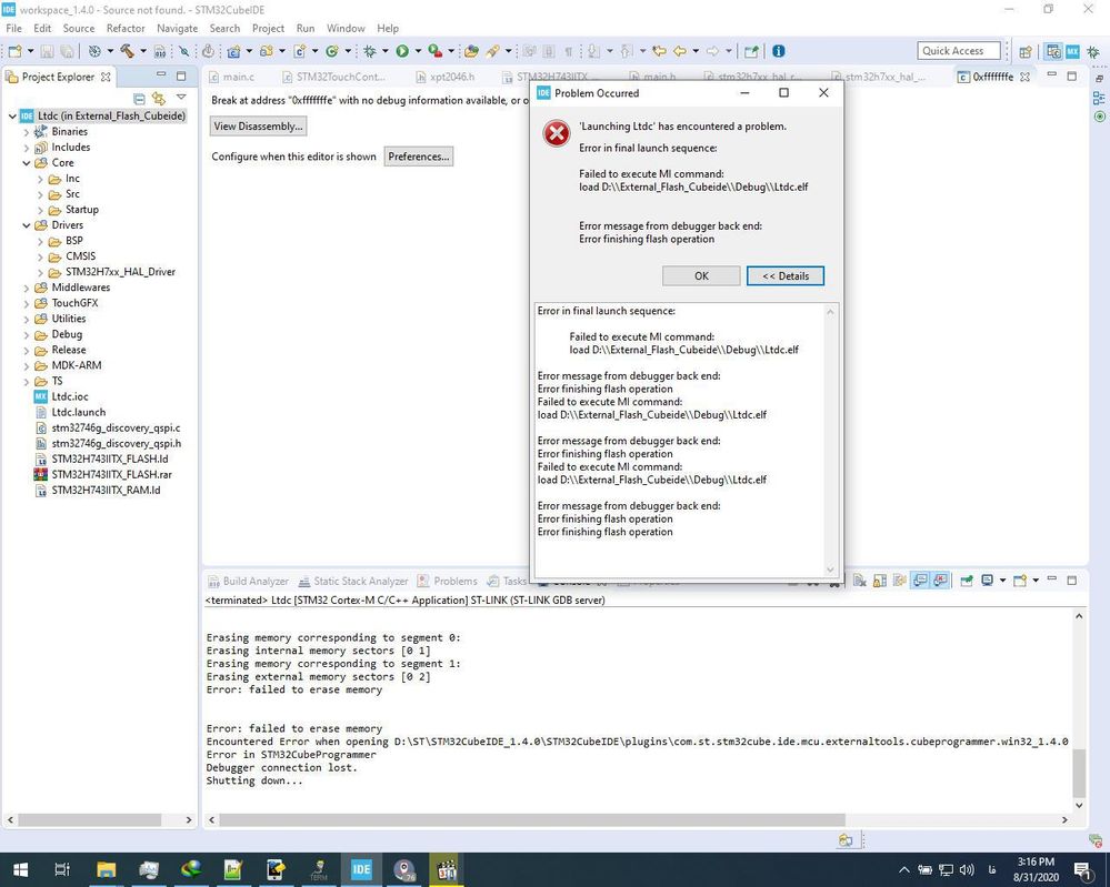

Hello friends
My problem is I can not widgets load to 25q256 via qspi I do not know what the problem is in my program, I put the project for you to find the problem, thanks

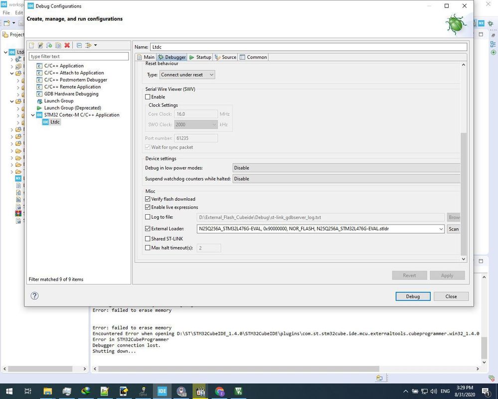

Thank you. I saw your content, but I did not understand whether it can be done by cube programmer external flash loader ?
Similar mechanics
STM32CubeProgrammer v2.5.0\bin\ExternalLoader\N25Q256A_STM32L476G-EVAL\Project\MDK-ARM

mbagh.1
Senior

Is there no one to answer my question?:loudly_crying_face:
I'm not using CubeIDE, I'm not building external loaders with it, and you can't "debug" them in the classic sense.
You'd have to build a test harness to exercise the code.
I don't think you can just slap the L4 example into the middle of an existing project.
I mentioned earlier in the thread that you can build a mechanism into your existing project that can program the QSPI. It for example could detect that the QSPI content is not correct, and enter a loader mode, that could for example pull data from an SD card, or X-MODEM over a UART.
I think one of the TouchGFX app notes suggests something like this. Board bring up blog cited earlier.
Here, at the very least you'd need to implement Erase / Write code for your Winbond W25Q256 devices.
Not sure what local resources you have for training, senior colleagues with loader experience, or contractors/consultants,.
