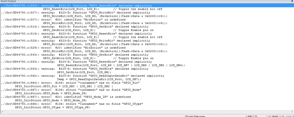

Raahul Jagannathan
July 2, 2018
Posted on July 02, 2018 at 13:38
I am getting the below attached error, when I trying building this. What have I missed out on?
