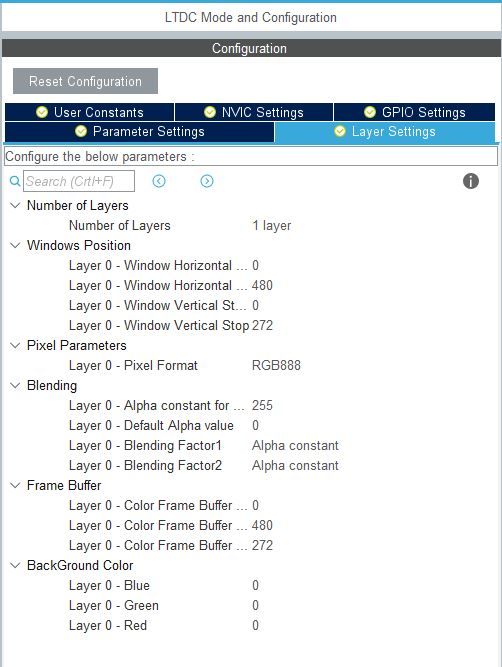

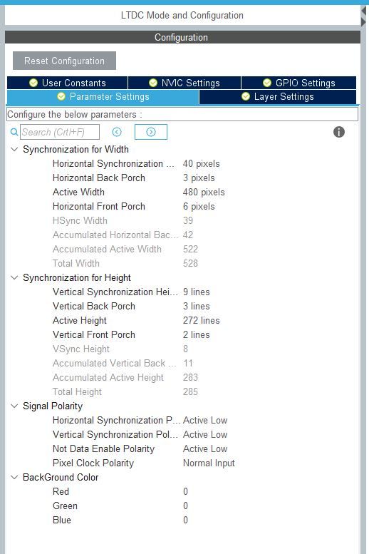

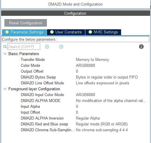

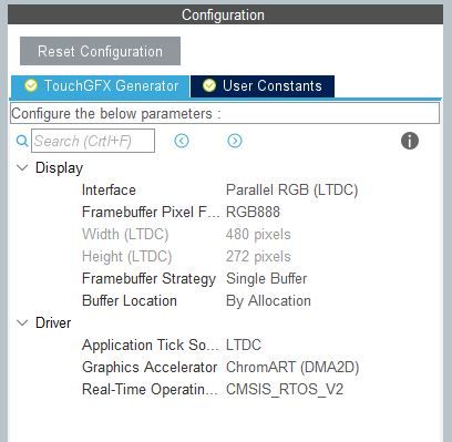

My main approach was to disable all the FMC and QuadSPI configurations on CUBEMX, choose pins for LTDC from Schematics of STM32H750B-DK, enable DMA2D, choose CMSIS_V2, and set all the necessary parameters of TouchGFX (I was also using singlebuffer). Then i imported the CUBEMX project to CUBEIDE.

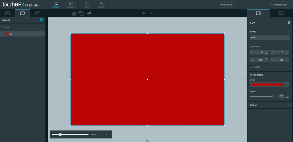

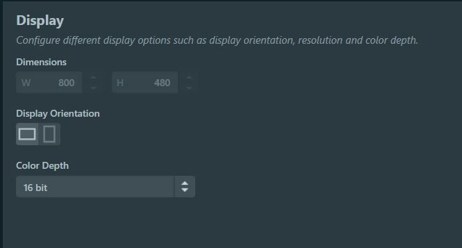

When imported, i used .part file to make the GUI but the screen size doesnt seem to fit my configs(configs was 480x272, the GUI designer recognised it as 800x480.) . Can these all be related with FMC QSPI adjustments? If not was my approach correct for custom board?

I'm not sure why the dimensions are not right. If the part file has the right dimensions that should never happen, so what do you mean by "configs was 480x272".

So from cubemx i choose these options:0693W000002ldu5QAA.jpg0693W000002ldu0QAA.jpg0693W000002ldtbQAA.jpg0693W000002ldsxQAA.jpg
shouldnt these configurations generate a .part file for a screen size of 480x272

Yes, the part file should reflect these settings. Do they? Post it.

I can not change the Width and Height parameters on the TouchGFX also. And the color depth automatically set to 16 bit.
