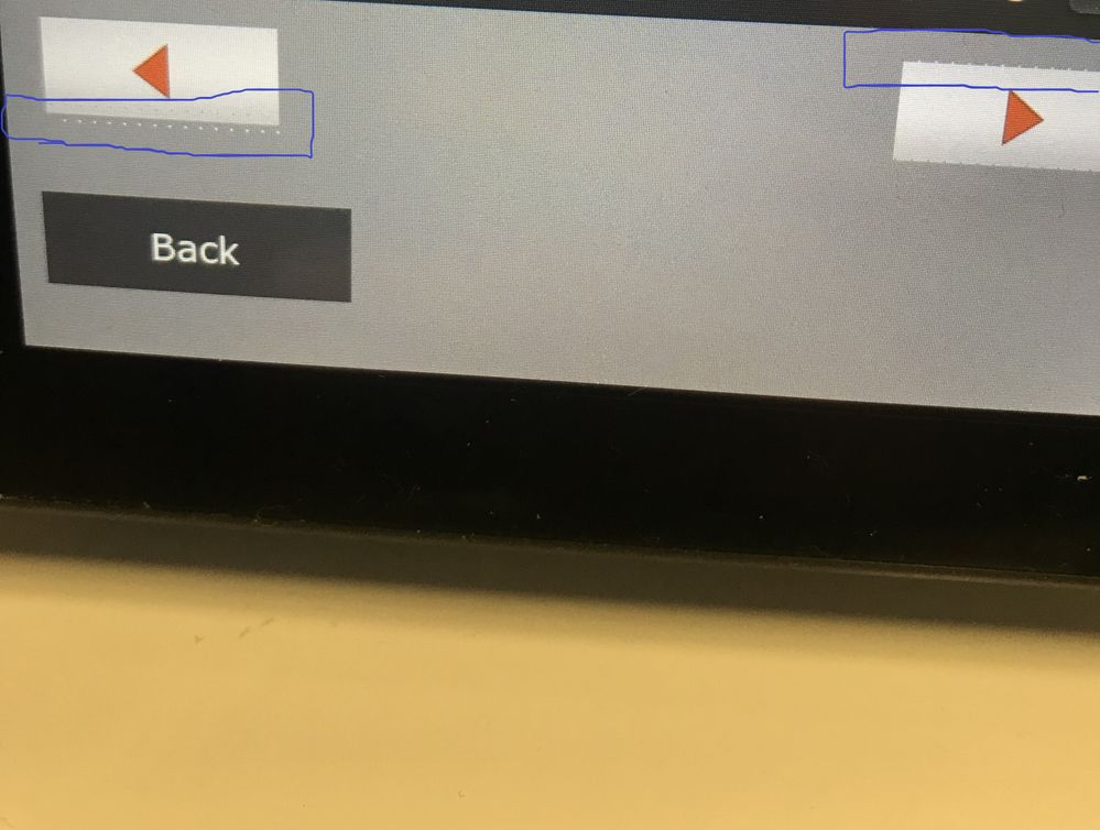

I use flash memory ( at25sf128) in my project and I can read data from flash correctly, I checked it . Also I checked the configuration of quad in out fast read command. However, The images do not have correct view on LCD. Have you ever had this problem before?

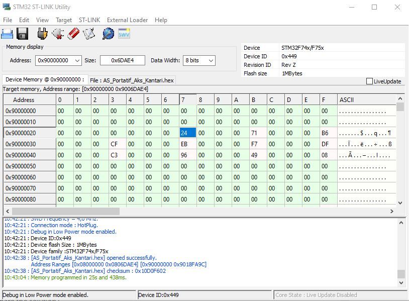

0693W00000GWSA7QAP.jpgControl of the memory with stlink;
