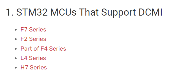

what I mean is that I am looking for a 'ST development board/kit' which can support 'qvga ir camera parallel interface' and provide the HDMI/USB/LAN ports to display as per the further connectivity. what I found out is that DCMI functionality supports the 'camera parallel interface' and few MCUs which supports DCMI from here https://www.arducam.com/stm32-cameras-that-support-dcmi/ since I am new to this, I didn't find out the proper suitable 'development kit' based on these MCUs which meet my requirement and simple in development as well. Please suggest if any. Thanks.
