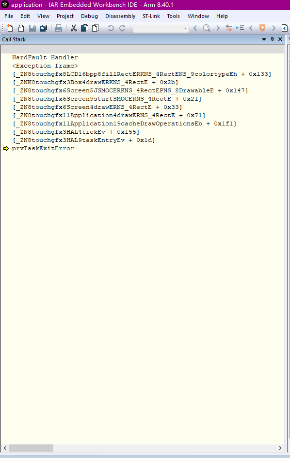

Hi Martin@Martin KJELDSEN​ :
How to use it without DMA2D?And I can't understand how to use HAL::flushFrameBuffer(r); in my project.@Martin KJELDSEN​
#define HAL_CLASS_TYPE    MyHAL
HAL& hal = touchgfx_generic_init<HAL_CLASS_TYPE>(dma, display, tc, GUI_DISPLAY_WIDTH, GUI_DISPLAY_HEIGHT, (uint16_t*)dynBitmapsBuffer, DYN_SIZE, MAX_DYN_COVERS);
Is this the right way to use it?I use HAL_SPI_Transmit_DMA(&hspi1, (uint8_t *)pimage, 240*240) to send image,so can I use thisway to send farmbuffer
to screen?

Jack li1
Hi Martin:
Thanks your help! It can display on TFT by touchgfx.
Best regards!
