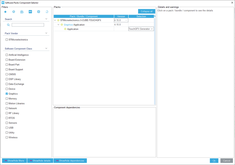

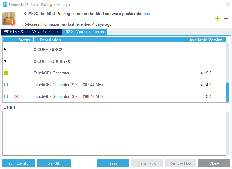

I'm using CubeMX 6.0.1. I have selected and installed the software package TouchGFX Generator 4.15.0 from Software Packages Manager:
0693W000005D1pkQAC.pngFurthermore I have selected TouchGFX Generator from the Component Selector:

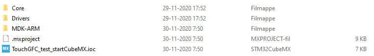

I don't know how it's supposed to look like, but here are the only folders that CubeMX generates for my project, with no hidden folders, and no .touchgfx files to find anywhere within that folder - or anywhere else it seems.
0693W000005D1rCQAS.pngThe only way it's possible for me to generate .touchgfx files, is to do it "manually" from the TouchGFX Generator-software.

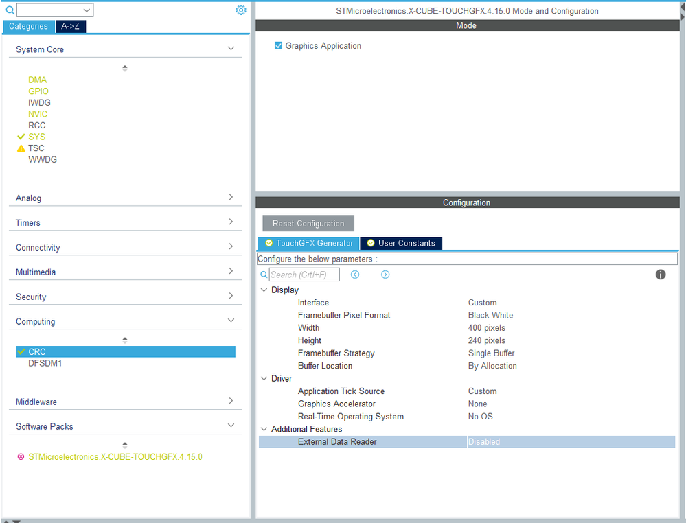

Update: from within CubeMX's Pinout Configuration, under Software Packs in the Categories-tab, I found that you also need to activate the TouchGFX-driver - which seems to become available AFTER the software pack has been enabled in the Software Pack Manager, and the application has been selected under Components Selector.
0693W000005D1viQAC.pngSeems a bit entangled way to do it, but now the TouchGFX folder gets generated in my CubeMX-folder. :thumbs_up:
