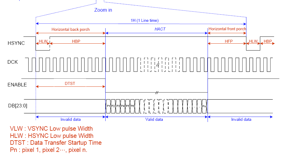

I have STM32H7A3ZIQ Nucleo board and 5" Startek LCD KD050FWFPA011. I'd like to use CubeIDE to create code to copy an image from H7A's flash memory to the LCD using LTDC. I did get STM32H7A3ZIQ Nucleo to work with a 2" LCD using 4-wire SPI interface. The problem I have with 5" LCD is the LTDC interface. Attached is IOC file, CubeIDE code, init code from Startek, scope captures, etc.... Please help.
I got black screen. Backlight is on. IDE reports the image (Mushroom480x800) is defined but not used. Scope captures show 0x00 on pin LTDC_R4. LTDC_CLK is 24MHz, correct as designed. What do I miss?

LTDC_IRQHandler(void) is never been called. I've been looking for reason why IRQ is not generated.
From scope captures, VSYNC and HSYNC are generated continuously. RGB data lines are 0x0.

I issue ALL_PIXELS_ON/OFF commands, and LCD goes white/black. So LCD is init'ed correctly.
Scope capture shows CLK, HSYNC, DE, non-zero RGB.
Check your PCLK DE and SYNC signals polarity with pdf
Startek signal names are confusing. So I checked them many times yesterday. Comparing scope capture and Startek pdf (below), it looks right.
