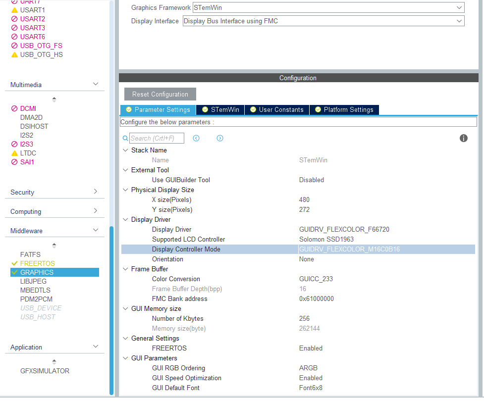

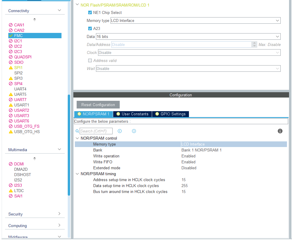

Hi people, recently I connected an LCD screen to my stm32F469VETx MCU. I configured an FSMC interface for communication. The screen turns on but when I try to write something to the screen nothing happens. Can anybody tell what could be the problem?

Check you can actually read back registers you have written, or you can read an ID or WHOAMI register.
Could be a million reasons why you failed, present your problem better, so someone could recreate your setup exactly from your description.​
I configured the display and drivers using cube. These are the main configurations for the display:
yshnaider
And when I try to display the simple example with "hello world", the mcu writes only to 2 of the data pins...
