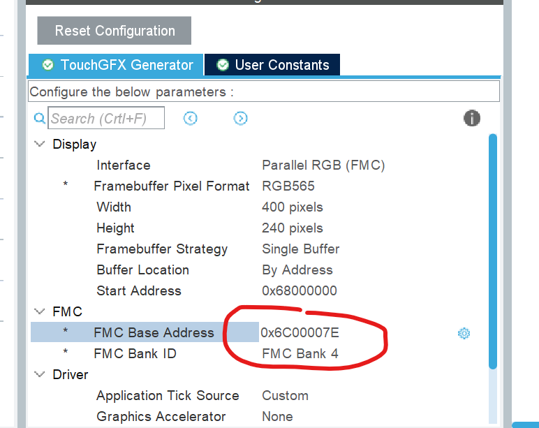

Hello Why I set the FMC Base Address as 0x6c00007e in CubeMX, but this value is changed to 0x7800007E?
jee

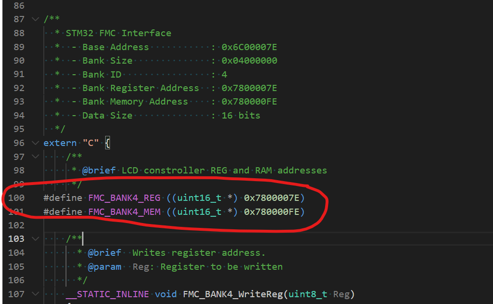

0693W00000D1o9WQAR.pngbut this value is changed to 0x7800007E

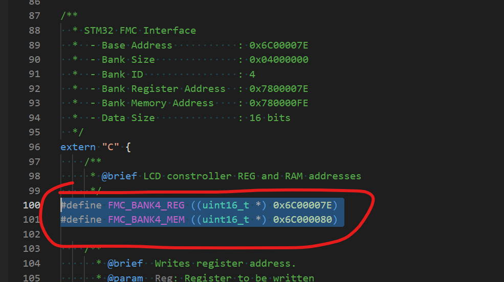

0693W00000D1o9lQAB.pngand lcd doesn't show anything. I changed this value to this.

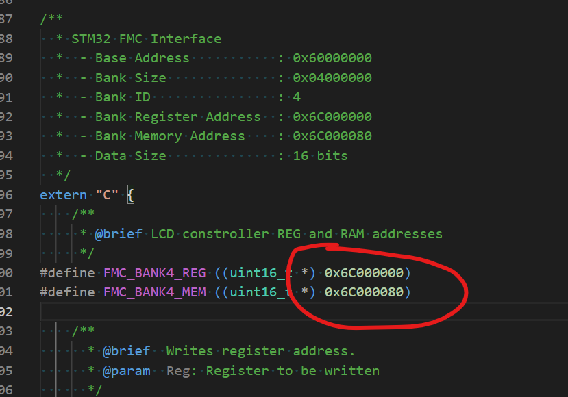

0693W00000D1o9vQAB.pngIt works properly.

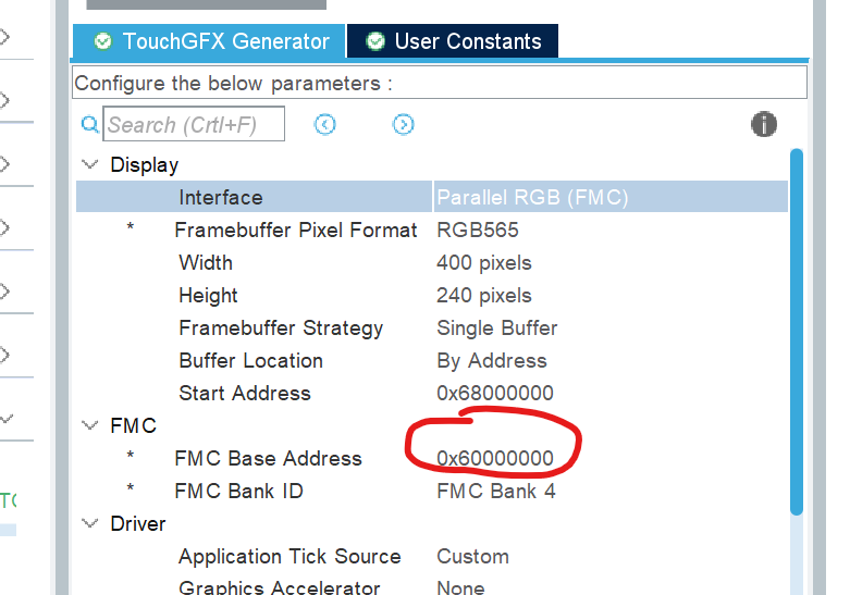

and I changed the value as 0x60000000,CubeMX is automatically generated correctly.
