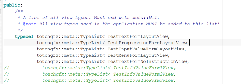

I have problem with the Heap issue (for many views I think)
I try to comment some view in FrontendHeapBase and it can flash into kit, but I found out in some view using more heap than declare --> it errors.
Can you help me fix this problem??

Hi Martin,
It's excessive recursion in FrontendHeapBase and I comment some touchgfx::meta::TypeList< ... View/Presenter,
run is ok on kit, but some views with lots widget, it errors.

with lots views in FrontendHeapBase declare by Designer, I can't compile code.
I just comment some to not excessive recursion -> compile ok but when run on h747 kit, some views with large heap size
--> it freeze at this view. Can you help me fix that problem.

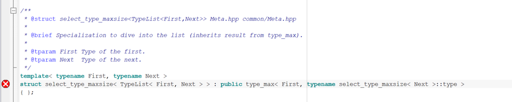

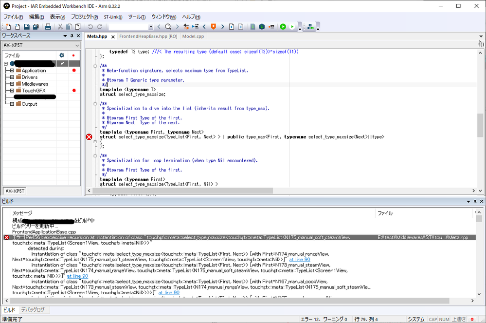

I have similar problem. I try to add 65 screens and build, then OK. But add 66 screens, then ERROR with IAR compiler.
ERROR[Pe456]: excessive recursion at instantiation of class "touchgfx::meta::select_type_maxsize<touchgfx::meta::TypeList<N175_screenView, E:\test\Middlewares\ST\touchgfx\framework\include\common\Meta.hpp 90  0693W000004JNSMQA4.pngGCC compile (simulator) is OK.
Could you please help me?
I found that C maximum recursion just about 64. You need to set your complier using only C++ language to solve this.
Thank you for the prompt response.
I confirmed to resolve with adding build option on EWARM (--pending_instantiations 0).
