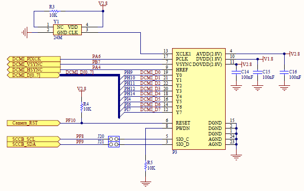

I'm skeptical about the pe0/1, why do so many boards have it tied to dcmi if it is tied into the accelerometer which by default has puPd interrupts? If these two bits were always being pulled low no wonder I've had so many issues with my cameras. I had rgb working for a while but it never looked quite right. I do plan on using the accel and investigating I can make those interrupts open drain by modifying CTRL_REG3 (22h). Then if I disable the interrupts all together I may see a change in my data. I'm no EE but I think open drain if always disabled will not drive the bus it is connected to. Cant believe I spelled interface wrong ! I dont work on this again for a few days but I'll update my post with my findings.- Mark as New
‎2013-09-19 6:30 AM
The Dragon407 has them on PH11/12 (all DCMI Dx pins are H/I banks)
The joys of low pin count STM32 parts, and that the F4-DISCO isn't a straight break-out board. The 100-pin devices are particularly frustrating. I'm using the 144-pin parts, as is the Dragon407. They *REALLY* should have used the 176-pin part, as it's still awfully clashy with the external FSMC (SRAM/NAND/LCD), Ethernet, USART, SDIO.Up vote any posts that you find helpful, it shows what's working..

This is so Great ! I changed the solder jumpers to use c8 and c9 then used those pins within my app. From there I do a DCMI->DMA->Mem transfer, on completion of that the state changes and I do a Mem->DMA->Uart Transfer. From there I have a python app that pulls the data off the serial port and saves it as a file. I attached a 160x120image.

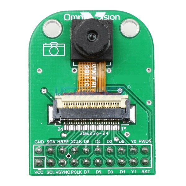

I am trying to interface OV2640 with STM32F4 DCMI to use it in pfoto mode(to take the single pictures). The datasheet for OV2640 is very poor, the modul with ov2640 have no all signals that have ov2640 chip. Please, help Me to understand following:Is thare a way to take single photo by ov2640, store it in ov2640 for some time, and than transmit it to my CPU , or ov2640 can only produce video stream, and it is my duty to catch one frame of it and save it in memory, fast enough to keep up with the data output from the ov2640 ?
