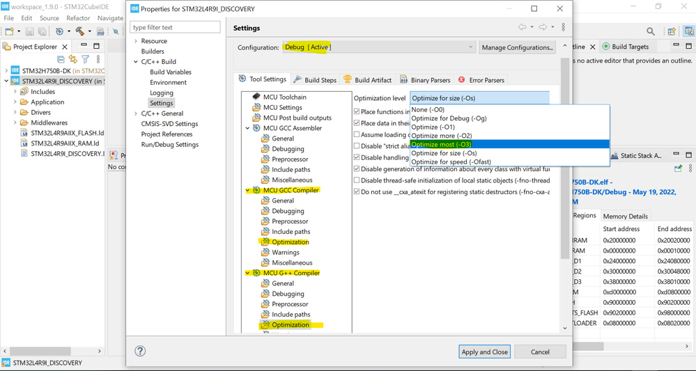

‎2022-05-30 1:58 AM
Hello Balavardhi,
I'm not sure if this will help but can you try the optimization option with CubeIDE ?
(select "Optimize most -O3" for both GCC and G++ compiler on Debug and Release configuration)
/Osman
