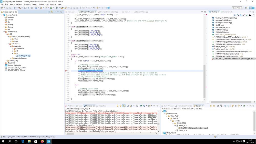

You need to install ST-Link utility. Our Makefiles use it so that you can "Run target" - And for boards with external Flash the external flashloader .stldr's are also referenced from within here.
/Martin

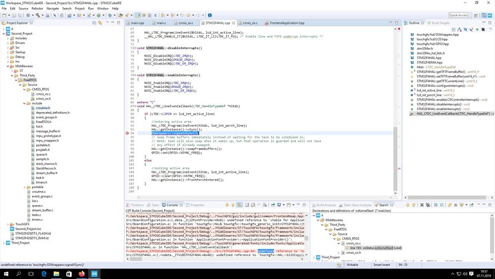

Can you find OSWrappers.cpp in your project? That's where the missing symbol is coming from.
/Martin
Artur_B
Is your project set to compile C++ or just C ? Seems like there are a lot of symbols from cpp files missing.
/Martin
