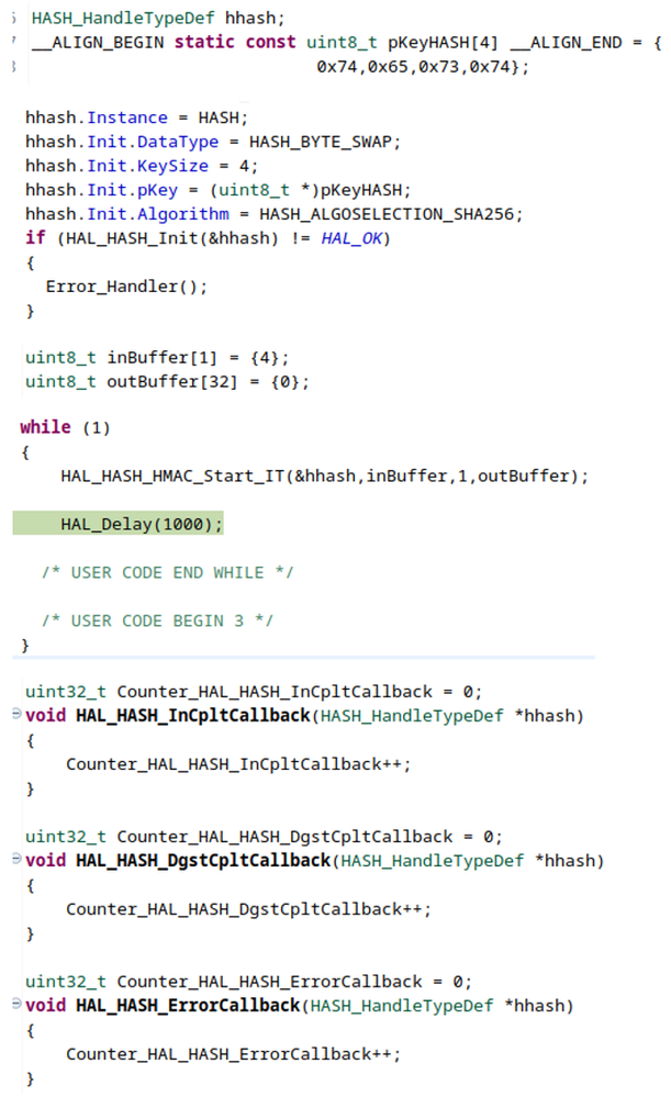

Hello, can someone explain the following behavior to me? Is this a bug or am I using the HAL incorrectly?
Thanks a lot.
Code snippet

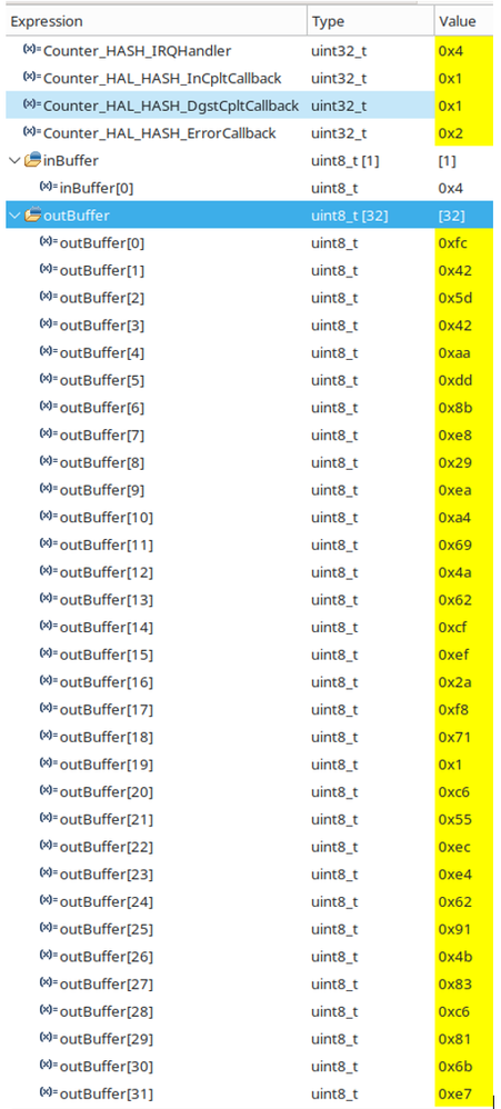

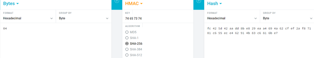

The result is correct, but the behavior is strange. I receive two error callbacks also.

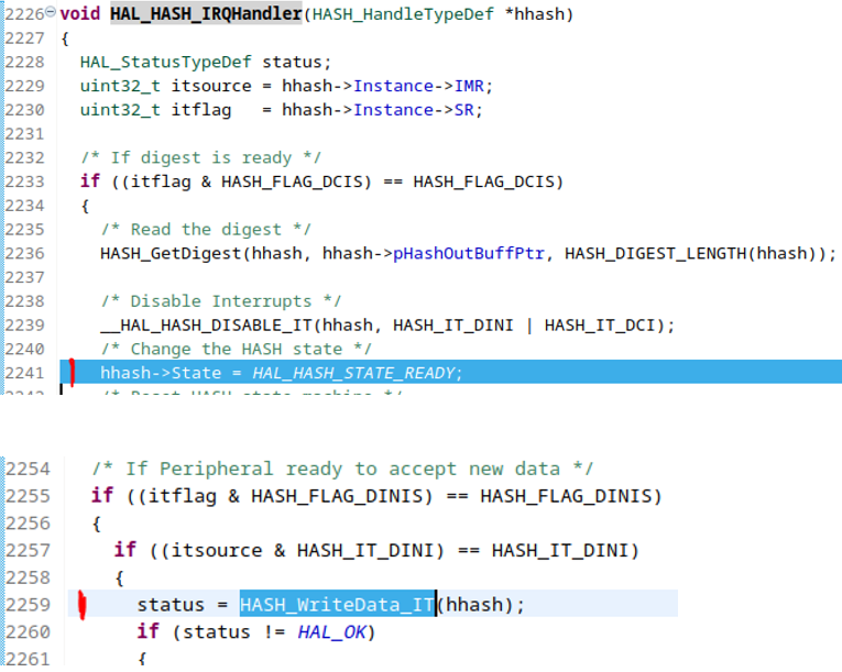

  • First IRQ
  • Second IRQ
    • HAL_HASH_InCpltCallback
  • Third IRQ
  • Fourth IRQ
    • HAL_HASH_DgstCpltCallback
    • HAL_HASH_ErrorCallback

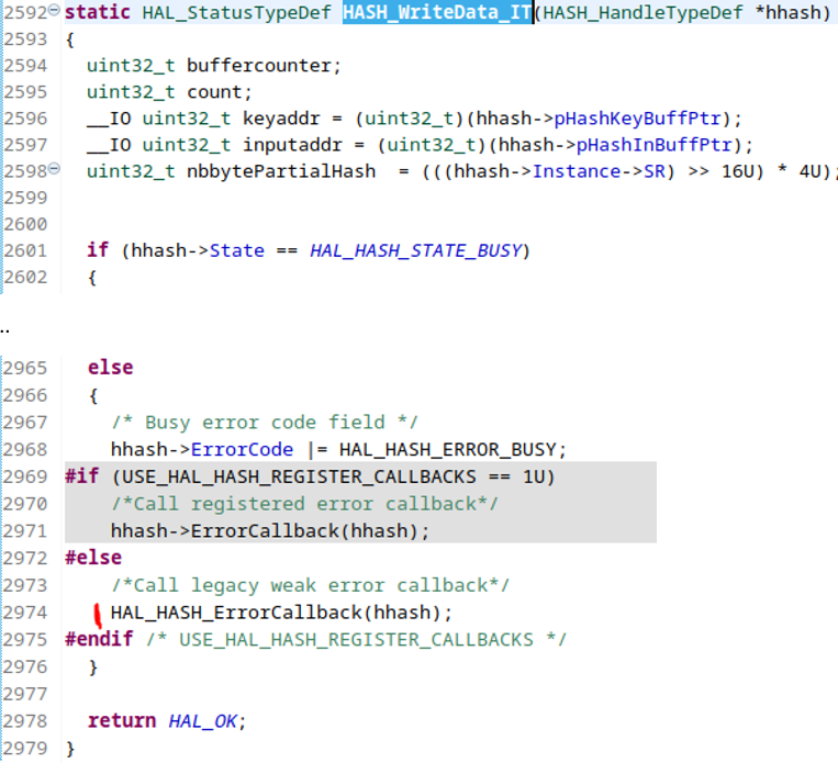

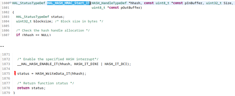

My analysis
First HAL_HASH_ErrorCallback due to:
  1. state = READY
  2. calling WriteData_IT
READY state leads to ErrorCallback
Second HAL_HASH_ErrorCallback due to:
  1. With __HAL_HASH_ENABLE_IT starts the process described above (four IRQ’s)
  2. Then, calling WriteData_IT and the READY state leads to ErrorCallback again

Hello @ser ,
I confirm this issue, the HAL function is not supposed to arise errors when the configuration and call to the function and the result is calculated correctly.
this has been reported internally.
