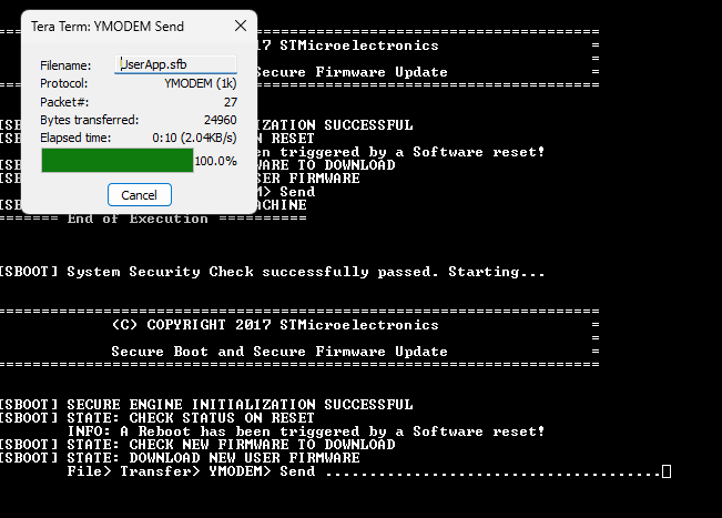

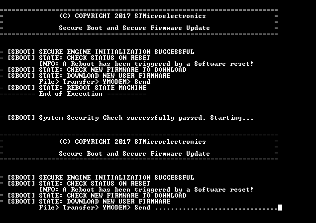

I'm having trouble transfer the UserApp to SBSFU. Here's the description of the issue.
I am working on SBSFU on STM32H753-Eval, So i altered the given sample for my UART to map to ST-LINK VCP. I am able to see logs post this changes. Later I Dissabled all security stuffs with below macro and fully erase the board (by setting RDP level 1->0 ).
I'm using the 2-Image example code, All security feature were disabled by
#define SECBOOT_DISABLE_SECURITY_IPS
 in app_sfu.h. I loaded SBSFU.elf onto the board and transferred the UserApp.sfb via YMODEM. However the program went into a infinite reset loop. It is rebooting every time i send UserApp.sfb.
I tried Increasing the Download Timeout from 3000 to 10000 from this macro, same issue
/* Teraterm YMODEM */
/* #define SFU_COM_YMODEM_DOWNLOAD_TIMEOUT        ((uint32_t)3000U) */
#define SFU_COM_YMODEM_DOWNLOAD_TIMEOUT        ((uint32_t)10000U) /*
Is there any specific step i need to follow ?... kindly guide me here.

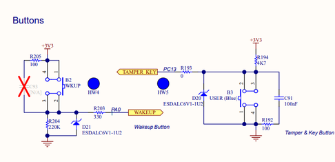

The issue was that
BUTTON_PUSHED()
was relying on the original BSP button API from the NUCLEO board.
Since this BSP does not match the STM32H753I-EVAL2 hardware, the button state was interpreted incorrectly during boot.
As a result, SBSFU always considered the button as pressed and entered:
SFU_STATE_DOWNLOAD_NEW_USER_FW
instead of continuing the normal boot flow and jumping to the installed user application.
To solve the problem, I removed the old BSP dependency:
#include "stm32h7xx_nucleo_144.h"
and created my own board-specific implementation for:
  • LED initialization and control
  • button initialization
  • button state reading
i have added the board-specific implementation under 2_Images_SBSFU\SBSFU\Target\sfu_low_level.c and  2_Images_SBSFU\SBSFU\Target\sfu_low_level.h .
In my case, I used the Wakeup button as the user button (PA0) .
