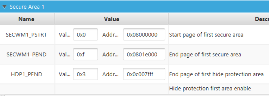

I have configured HDP as follows :
0693W00000LzCUYQA3.pngBy Bootloader .icf details are :
define symbol __ICFEDIT_region_ROM_start__       = 0x0C000800;
define symbol __ICFEDIT_region_ROM_end__        = 0x0C007FFF;

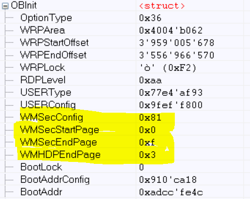

Configurations when i debug the code are also fine :

HDP is applied on Bootloader region:
i.e WMHDPEndPage = 3 of Bank 1

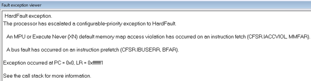

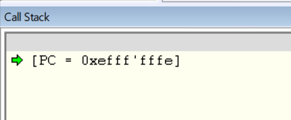

Secure App then jumps to Non-secure App :
here firmware kind of hangs and program counter shows
[PC = 0xefff'fffe]
I have checked HDP by applying it to BANK 2 ,which is working fine.
But when i am applying it to Bank1 (where my code lies) this issue occurs.
