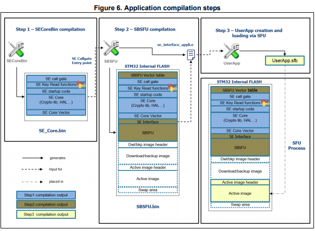

Secure Boot and Secure Firmware Update is just awesome. Very excited to use it. However, for whatever reason, the process of setting up and practical usage of it is quite confusing.
I've loaded the demo application(s) into Atollic and found that nothing works to the degree that the application notes explain. Have the ''Hands on'' workshop but found it more of a ''load the demo.... see it works'' but little in the way of explanation.
I've been using
http://www.st.com/content/ccc/resource/technical/document/user_manual/group0/33/ee/5b/6b/c7/43/44/3e/DM00414687/files/DM00414687.pdf/jcr:content/translations/en.DM00414687.pdf
This should be clear but it isn't.
Here is my understanding:
  1. Start a project that will be the ''SECoreBin''. It has no main and is compiled as a object file that will be used in the next step.
  2. Start another project that is the SBSFU and it will use the object file from step &sharp1, it also does not have an entry point so it is also compiled as an object file.
  3. ? User app create..... Isn't the user application part of the project? Is the only way to load the user application is through the SFU process?
What I'm looking for is some clarification and ideally some more detailed instructions on how the project workflow is setup.

We as well as the Getting Started doc, we followed readme.txt  files in the source and were able to build everything using IAR, and got the demo to work on a Nucleo L476RG demo board.
The user app is a separate project because the post-build steps create an encrypted and signed binary which only your bootloader can receive and de-crypt. It's a really nice system and will be very useful to us when it is fully developed.
We found that user apps that were not correctly encrypted would be send OK but did not run - the failure was silent, so it was difficult to see if SBSFU was working correctly.   We discovered it was, but an error message on decrypt failure would help us.

I've ported it over to Atollic without too much stress. The difficult part for me was the lack of detail in pre-compile / post-compile commands. Inclusion of what directories and which libraries. Had to dig through the .project files to find those details.

SBSFU is the actual bootloader application and not just an object file. After building the SECoreBin you can build the SBSFU and load it into the controller using stlink. When u build the user app project u may notice that there is a merged binary which is also created that is a combined binary of SBSFU,SECoreBin and the User App. U may flash(stlink utility) this to flash both bootloader and app in one go(e.g. during production).
