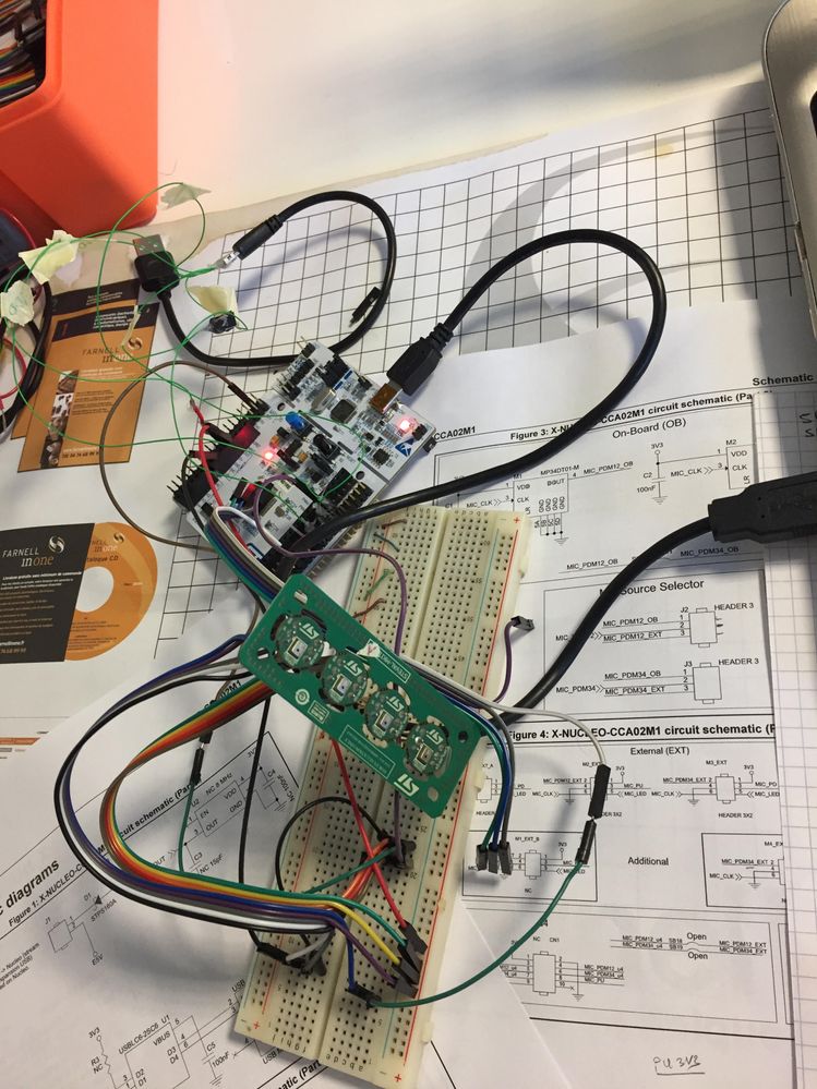

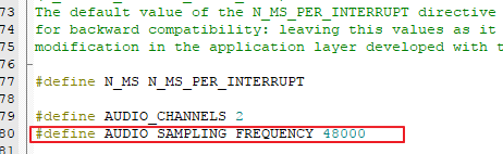

hi, I have a stm32l476 necleo-64 board and CCA02M1 extension board. I want to modify the the Microphones_Streaming example. and I want to use it to record 4 channel microphone and with 48000Hz sample rate. and I just change the macro definition AUDIO_CHANNELS in the aduio_application.h. change the 2 to 4
&sharpdefine AUDIO_CHANNELS 2 ------------> 4

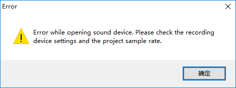

but the Audacity didn't work after the change,it reprot error like this
and the the same thing happens when I change the AUDIO_SAMPLING_FREQUENCY to 48000
and I think mabe I should change the USB descripter at the same time, but how to modify it ?

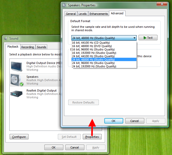

You need to change the sittings of you'rerecording device on windows: Audio sampling frequency and Audio channels.
