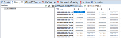

Hello, I am developing a dual processor application with a host (STM32F205xx) and a slave (Radio Module SoC). The idea is to update the wireless module's firmware from the PC via the virtual COM port.
The firmware is temporarily stored in STM flash memory. The problem is that only the first segment is saved correctly. Attempting to save the next segment to flash memory will cause the Virtaul Com port to reboot.
When USB data reception interruption, the function below is called, the flash address was set to 0x080E0000 (will be cleared when STM restarts)

After the ReceiveSegmentClb function is executed, the CDC_Transmit_HS(functionStatus, 1); shall be called.
As can be seen from the image above, the first write was successful. On the PC side, the response comes correctly, but the next segment write cannot be started because the STM restarts itself.
What am I doing wrong?

‎2023-09-12 1:34 AM
Thanks for the advice, I checked the transmission chain and... I made a stupid mistake, I tried to write packets (via USB) that were larger than 64 bytes, which caused the internal logic to collapse. The FSM has interpreted the next data part not as a part of previous data transfer, but as a command to "reset" the STM...
‎2023-09-11 7:20 AM
Look at the RCC->CSR flags on startup to determine the cause of the reset.
If that doesn't help, I'd recommend separating USB from the flash write. Try to write the new bootloader with dummy data and see if that works or triggers the reset. If it works, problem is likely in program handling or USB or some other program logic error.
