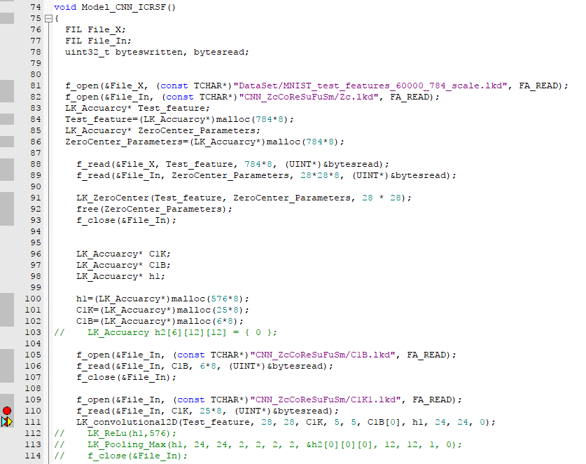

in my function, several heap pointers are defined like this
when I comment the 111 line. the whole code works well. But when I add this line, the pointer Test_feature, ZeroCenter_Parameters, C1K,C1B will all, or sometimes partly, point to 0x000000.
eventually in 2 debug with the same code, it may different.
so the Question is:
In general, What will let the Heap pointer point to 0x00000? before free.
for my observation, the heap size is enough on my project (HEAP SIZE=0x8000, the same as stack size). I'm using STM32F746NG-Discovery Board so the RAM Space(at least 240KB for algorithm) is also enough. So it may be the problem of the IDE or Compiler?

Posted on July 28, 2017 at 21:02
h1=(double*)malloc(576*8);
memset(h1,0,578*8);
You allocate 576 units and use 578, trashing the arena.
Your free(a) example is STILL broken, you can't advance a and pass the new pointer in.

Posted on July 28, 2017 at 18:21
malloc() returns zero to indicate that the heap is out of memory.
Make the heap big enough to service your needs, see size defined in startup_stm32fxxx.s, make a localized copy in your project directory without the read-only attribute set so you can edit it.
The free() in your test case isn't being passed the pointer that was actually allocated.

Posted on July 28, 2017 at 18:36
Calling free() with an address it didn't allocate will likely trash the memory arena.
Don't free(a += 1024);
Every time you call malloc() you need to check if it returned NULL before you attempt to use it. You should also make sure not to free(NULL). Nest your malloc/free so that failure unwinds, and doesn't compound.
so, do you mean, if one pointer is over heap when it was malloced, all the others will be changed back to zero?
No, but if you take a pointer and zero memory you can trash other parts of the heap or stack if the pointer is damaged (see freeing the wrong pointer)

   double* h1;
   memset(h1,0,578*8);
   double* C1K;
   double* C1B;
   C1K=(double*)malloc(25*8);
   C1B=(double*)malloc(6*8);
                           /   *some operation, all function   */
the heap this part needed is around 13 Kbytes. And free heap space is 0x8000=32 Kbytes.
The problem is:
      When malloc the C1K and C1B, it return NULL, the others work well.
      But when I comment the 'memset(h1,0,578*8);', all malloc works well.
the A B h1  get the same address with and without the memset line.
what do you think will let the C1K C1B get zero in general? Only due to the Heap Size limitation?
memset(h1,0,578*8);
