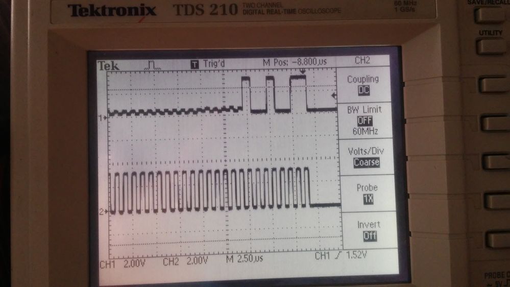

Using your scope, what do you see at the MISO line ?
The SPI interface has several clock polarity and trigger edge options, check with the datasheet of your slave device.
I suspect the slave does not really answer.
Posted on November 02, 2017 at 09:57
Clock vs MISO line. The last 8 bit should be the answer, seems correct.

Posted on November 02, 2017 at 10:31
At least it is non-zero, and you should be able to read it back.
I would check in the debugger.

Surely this is just a code, to check on the scope if they communicate at all. I am having troubles setting up the debug session, I cant set any breakpoints, or watch any variable, but this is a different topic, I will manage it.
In any case, what I concluded is that I definitely read 0's from the Rx buffer since the read instruction overwrites the variable spiRecived initialized to be 0xFE, which on the attached code might be zero now.
I also concluded that I do receive answer from the slave, because I checked the memory cells I am reading from, and the data on the scope corresponds to it. So the data is there on the MISO pins but somehow I copy 0's from the Rx buffer.
Im gonna try to setup my debugger, and see whats going on.
Ben K
Senior III
Posted on November 02, 2017 at 14:54
To me it seems that spiReceived value equals to the received byte during your transmission of 0x12, and that's why you get the wrong value. Take a look at TXE and RXNE flag timings in the Reference Manual. Wait for another RXNE flag and see if it resolves your issue.
Edit: I recommend reading and discarding the unused SPI DR values, as some STM32 devices have a FIFO implementation, therefore you might see older values if they have not been read before. This is also good to avoid getting overflow error flags.
