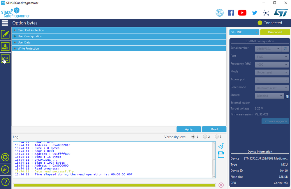

You can modify the BOOT1 state by using the option bytes.
  1. connect your device to the Cubeprogrammer
  2. select the option byte button "OB" like this :
then you can modify BOOT0 and BOOT1 according to your needs.

Boot1 is some Option Bit.

It looks like an error in AN2606.
Option bits are non-volatile configuration bits that control booting and security features. Read about them in chapters 2 and 3 of the reference manual.

Thanks a lot for your clarifying answer!
